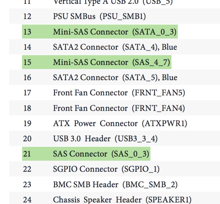

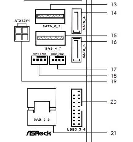

I don't know how far you came so here is what I experienced:
1.) not needed, I have 8 disc drives attached to the LSI controller (connector 15 & 21, see manual and pic's attached)
2.) no, all is running well including plugins, Docker and VM's (Mac OS X El Capitan, Ubuntu Server 14.04, Windows 10)
My issue is: I was trying to attach 2 more drives to the build-in controller (manual is saying: Intel® C224 : 4 x SATA3 6.0 Gb/s (from mini SAS connector), 2 x SATA2 3.0 Gb/s, Support RAID 0, 1, 5, 10 and Intel® Rapid). These two drives should show up at the UEFI screen but they are not. Let's see what the support will reply...

Have you seen my reply to mgsvr on the same question? Have a look I answered it already.
I was using a different cable, having now the setup that I want:
  • 8x spinner disc drives attached to the LSI controller using the mini SAS connector no. 15 & 21
  • 2x SSD’s attached the C224 controller that can handle 4 x SATA3 6.0 Gb/s. I am using port 0 & 1 attached to the mini SAS connector no. 13
  • 1x external connection attached to one of the  2 x SATA2 3.0 Gb/s ports
Remark: Everything that is attached to the LSI controller will not be seen in the UEFI overview!!
