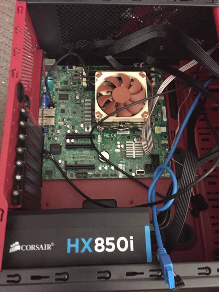

So here is a little inside shot of my new server
I have got the drives still inside of my old case and I measured from the edge of the motherboard to the front of the optical bays is about 21cm ish maybe 22cm.
Now to add to my shopping list is:
1 or 2, 5 in 3 bays
hba adaptor
extension cables for 24pin and 8pin cables
