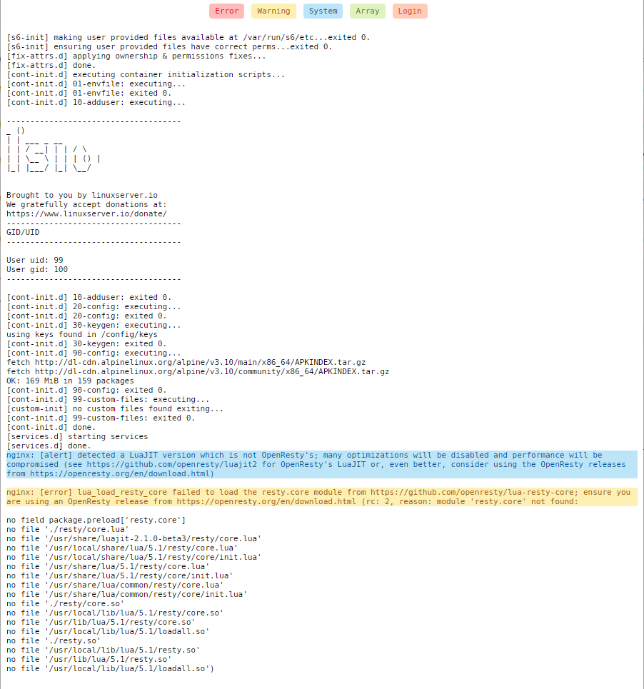

Hi All,
So i did an update to the docker around an hour ago so its on :latest with no further updates available and the startup logs now have started to show this:
[cont-init.d] 10-adduser: executing...
usermod: no changes

[services.d] done.
nginx: [alert] detected a LuaJIT version which is not OpenResty's; many optimizations will be disabled and performance will be compromised (see https://github.com/openresty/luajit2 for OpenResty's LuaJIT or, even better, consider using the OpenResty releases from https://openresty.org/en/download.html)
nginx: [error] lua_load_resty_core failed to load the resty.core module from https://github.com/openresty/lua-resty-core; ensure you are using an OpenResty release from https://openresty.org/en/download.html (rc: 2, reason: module 'resty.core' not found:
	no field package.preload['resty.core']
	no file './resty/core.lua'
	no file '/usr/share/luajit-2.1.0-beta3/resty/core.lua'
	no file '/usr/local/share/lua/5.1/resty/core.lua'
	no file '/usr/local/share/lua/5.1/resty/core/init.lua'
	no file '/usr/share/lua/5.1/resty/core.lua'
	no file '/usr/share/lua/5.1/resty/core/init.lua'
	no file '/usr/share/lua/common/resty/core.lua'
	no file '/usr/share/lua/common/resty/core/init.lua'
	no file './resty/core.so'
	no file '/usr/local/lib/lua/5.1/resty/core.so'
	no file '/usr/lib/lua/5.1/resty/core.so'
	no file '/usr/local/lib/lua/5.1/loadall.so'
	no file './resty.so'
	no file '/usr/local/lib/lua/5.1/resty.so'
	no file '/usr/lib/lua/5.1/resty.so'
	no file '/usr/local/lib/lua/5.1/loadall.so')
I've never seen these before and its happening on all my dockers using this image so it doesn't seem to be a configuration fault or anything else
Having a quick google this doesn't seem to be a huge issue but is something worth mentioning in case it does have an affect on anything i'm unaware of
Regards,
Jamie

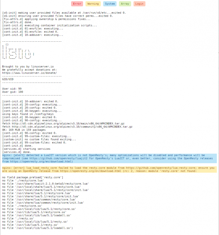

It's nothing to worry about, unless you use lua.
Hey Saarg
I didn't think it would be but thank you for confirming.
Regards,
Jamie

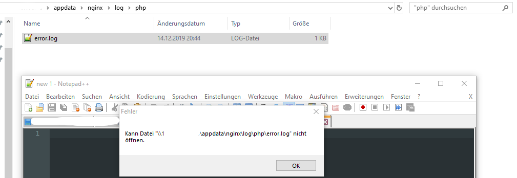

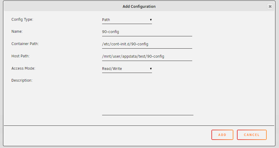

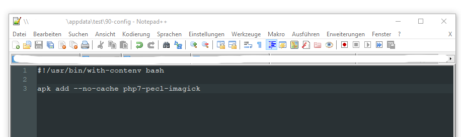

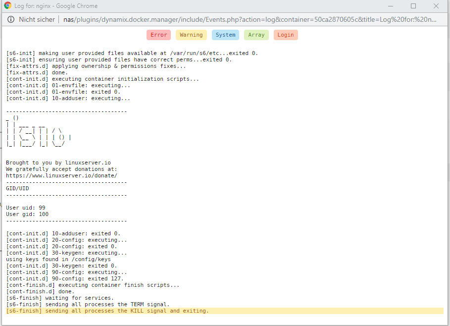

Hey, im trying to run dompdf in the container. It requires the module imagick. From a call to phpinfo() i can see that it is listed as module but with 0 supported formats. I also tried to add a "90-config" with
#!/usr/bin/with-contenv bash
apk add --no-cache php7-pecl-imagick
in it but the container just exits with code 127.
How can i solve this issue?
Also i can't open the
nginx\log\php\error.log
via the windows explorer - is that intended?

Most likely line endings in the script. Make sure it's Unix format
Thank you for the fast reply! You are right, i recreated the file with nano via SSH and the container is now starting. But im still getting 0 supported formats. This is the new console output:

Well very strange. Does your phpinfo also list "ImageMagick number of supported formats" with 0?
Maybe @linuxserver.io can you help me?
With this 90-config:
apk add --no-cache htop
apk add --no-cache libmagic
I get an output like:
