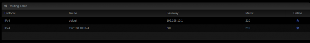

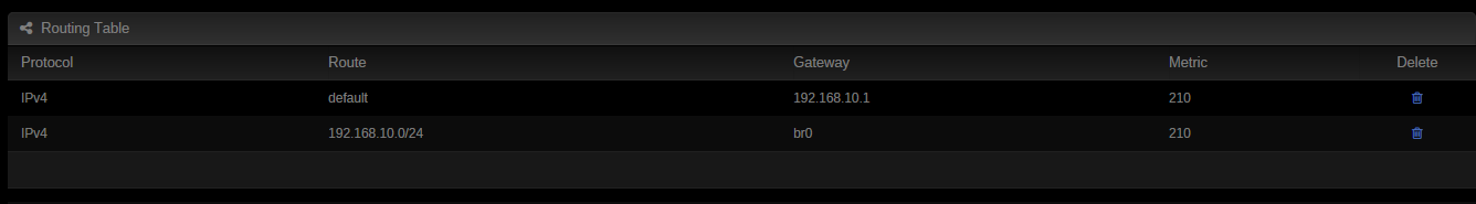

  • 5 months later...
On 12/7/2015 at 5:43 PM, johnodon said:
Did you set up a network bridge and name it 'br0' (Settings --> Network Settings).
Also, you have to set Default Network Bridge in Settings --> VM Manager to 'br0'?  If it set to 'virbr0', then your VMs will have their own virtual network.
There is no option for choosing br0, only vibr0.
