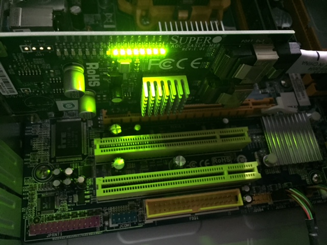

Ok, This Morning I told my system to grab 300 or so gig of files specifially off disc 2 to my Windows Desktop. I chose Disk2 because in the past I've noticed a pattern of my system freezing or doing this when I pick from Disc2 or at least I'm thinking it has. Ran a Quick Smart Test it shows nothing wrong. Well came home and found my Expansion card with lit up lights on the first channel. Oddly enough the Disc I was pulling from isn't even using it. Like usual nothing in on Screen Log file or no other log file to pull from. PC screen is black. Disc2 is still spinning or at least it feels like it is.  Keyboard doesn't respond, simply nothing does.
I can only conclude either Disc2 is causing this issue or the mother board is dieing. I'm going to let this Parity check complete and then I'm going to hammer the heck out of another drive by copying files and see if the problem repeats. If it does I'm going to guess its not Disc2 and it must be something system wide like the MotherBoard/PowerSupply or Sata Expansion Card. Maybe even my USB stick. Heck I don't know lol .
