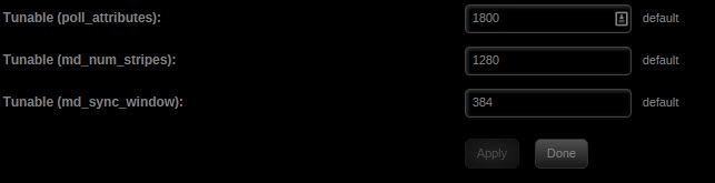

Where do I change the md_write_limit value? I don't have it under disk settings..

@strike on V6 md_write_limit can only be changed on the flash drive, flash/config/disk.cfg
Thanks!
