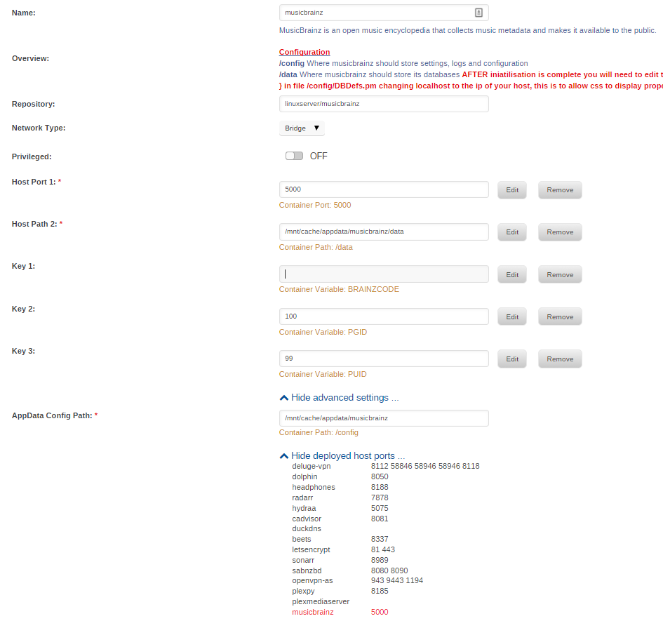

I also seem to be getting this "/config/postgresql .conf" spam when trying to install/initialise. Did anyone have any ideas how to fix?
Both @sparklyballsand @Squid 'replied' to @DZMM regarding this issue but never seemed to be addressed
I have removed and reinstalled Musicbrainz several times, trying different combinations of /user /cache /disk etc, while wiping the appdata folders.
I have also removed my docker image and rebuilt everything to no avail
I have attached a log, and my mappings. (I am using a BRAINZCODE)
Thanks

3 hours ago, DZMM said:
yes, my /data is mapped to /mnt/cache/appdata/musicbrainz/database
And your /config is mapped to /mnt/cache/appdata/musicbrainz?
