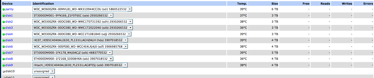

I've been avoiding upgrading since I was scared about breaking something that works.  But there is too many cool things that I'm missing out on that I had to try and upgrade.

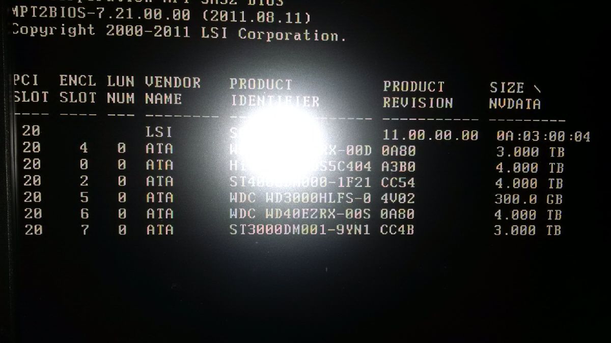

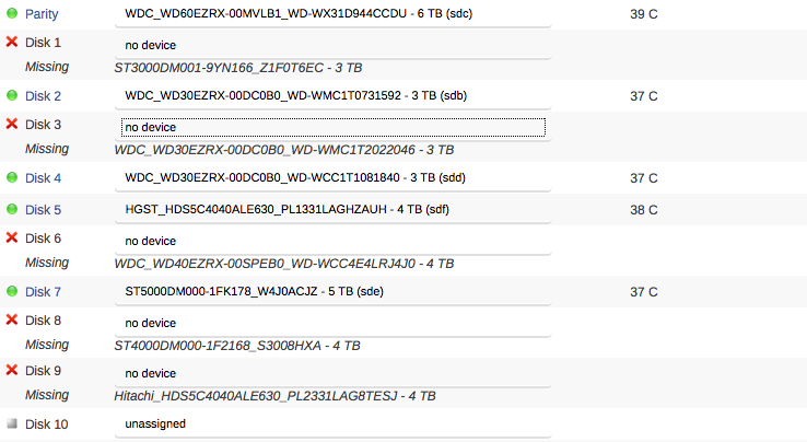

I didn't have a lot of complicated things so I went with the upgrade option to keep my share settings and disk configurations.  But when I start unraid, none of the disks attached to the SATA controller are detected by unraid.  I know they are recognized since they worked with unraid 5.05 and I can see them listed on boot.

Are they recognized by the HBA's Bios (I don't have an 9220, so I can't tell you if they are supposed to show up on the screen during a boot or not)
Are those the only 5 drives attached to the HBA?

Yes, the disks are detected on book.  I actually have 6 drives attached to the card.  One is the cache drive and that's on the bottom of the list (also missing).

Not quite sure what to tell you here...  There's some strange errors in the syslog:
Dec 18 22:18:19 Tower kernel: mpt2sas0: diag reset: FAILED
Dec 18 22:18:19 Tower kernel: mpt2sas0: _base_get_ioc_facts: failed getting to correct state
Dec 18 22:18:19 Tower kernel: mpt2sas0: failure at drivers/scsi/mpt2sas/mpt2sas_scsih.c:8237/_scsih_probe()!
I don't have one of those cards, so can't say for sure that it's compatible, but I'd be surprised if it wasn't compatible with 6 but compatible with 5.
I'd wait for someone more familiar with the LSI cards to pipe in... My best and only guess is firmware issue - But its a guess at that.

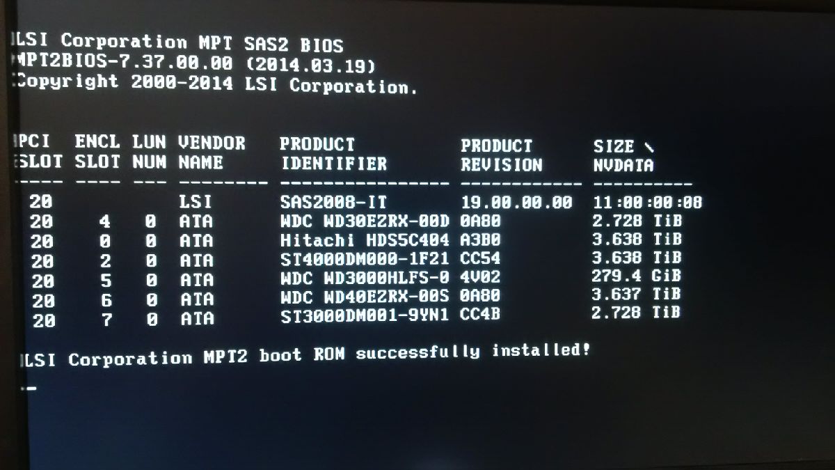

I’m assuming your M1015 was crossflashed to 9211-8i (since you are using LSI bios you can easily confirm by pressing CTRL + C during boot)
If yes download the Dell H310 P19 package from here and using the files from the 5_LSI_P19 folder type:
sas2flsh.exe -l Flashlog.txt -o -f 2118it.bin –b mptsas2.rom
Thankyou so much!  I ran the command and it seems to have worked.  But the drives are still not being recognised by Unraid :(  This is the logfile:

Should I try upgrading to 20?  But the rom you pointed to is named "mptsas2.rom" but the official one form lsi is named "ebcsas2.rom".  Not sure if they are the same :(
Thanks for your help!
If it doesn’t work with the updated firmware I’m out of ideas, as that controller is one of the most used by Unraid users.
