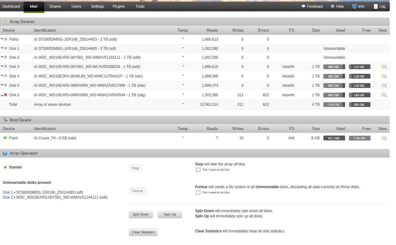

Power supply is not that old, and power connections seem fine everywhere else. it seems to be always this drive. Haven''t done a memtest now, I could of course do one, but why would that match up to the 1 drive?
Here is the new diagnostic attached, and screenie of what I see in main, which is what I saw when I checked again how the parity check was going  (again, after 12 hours of continuously working the pairty sync which came out fine..).

Ok, so if I try to read disk 6, all other disks spin up (of course) and what I see looks pretty much normal / what I expect, and same thing I saw yesterday when I backed up that disk to another location.
So what would be the way to proceed to jut replace it and bin that one? Like you say, with the 3TB parity I can use a 3TB which is what I have, *but* that disk I have is already assigned to the array (granted, it is in not formatted and umountable state).
Can I do it fro where I am (see screenshot in my previous post) or would I have to go back?
