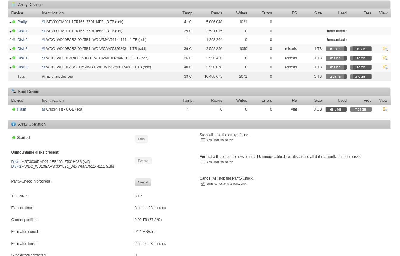

Ok, first part done... new arraym, only those "good" drives...
Parity Sync done ok with no issues, and now running the parity check.
I did notice what you mentioned about speed....  As the bad drive was on one of the ports of the PCI card, now that there are only 2 the speed I had with just 2 disks on it went up from the previous 35 to about 53-54, consistent (roughly) with the 133MB to share on that slot.... (well if regular max throughput is aroung 80% of max, we're right there..).

One last one re: the above. After the parity check finishes and I select to format the 2 drives, need I do anything else?
The ST3000DM001's are 1TB/platter ... so with that density AND 7200rpm speed they're even faster than WD Reds => they should hit ~ 200MB/s on the outer cylinders (the fastest part of the drive).
You should definitely notice a very nice bump in speeds on parity checks if you get the 2nd drive off that PCI card [when the check gets past the point where other drives are involved ... in your case after 1TB].
If you add a PCIe card that has enough bandwidth for the max speed of the attached drives, there's no advantage to a motherboard port.    For example, if you add a PCIe x1 card, and only attach one drive to it, there won't be any bottleneck even with your 1TB/platter 7200 rpm drives.    If your system has a PCIe v2 bus (and the card is also a v2 card), then that's true even with 2 attached drives.    If you have a PCIe x4 slot available, and use an x4 card, then you could easily attach 4 drives to it.
Your last comment is correct => after the parity check finishes all you have to do is format the 2 drives and you're done  :)

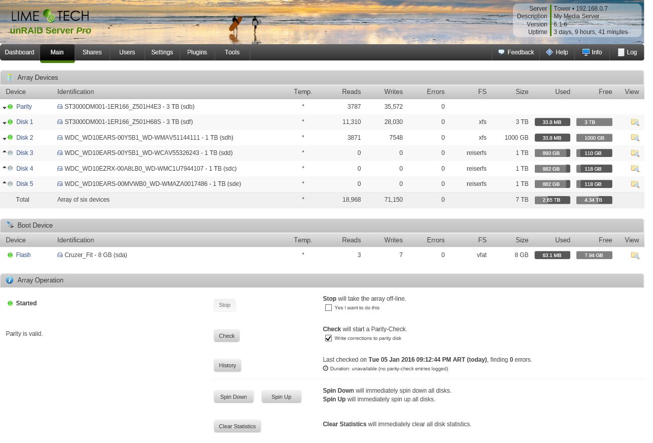

Quick question on something odd I noticed...
I was checking up on how the parity check is going, and while no errors were found, I see that the other disks that were already past their point (passed the 1TB mark in the check already) wew spun up, and there have been some writes... (see screenshot)
Is it normal, or is this maybe the fault of some device in my network (like a WD Live TV) maybe writing anything to it's media base...?
Any way to check?
Well..
Another oddity I found...
Formtted the other 2 drives, system did it as xfs the new default, and I see that the 3TB shows correctly(?) "3TB" but the 1TB, contrary to the others shows 1000GB instead...
Is this right/new behavior? Why on this drive and not the others?
Well..
Normal... Known issue
Well..
Thanks!  Won't worry then...
Everything looks fine -- as noted, the 1000GB is a known issue; and the writes you noted were undoubtedly done by some process you hadn't thought about simply writing to the array.
