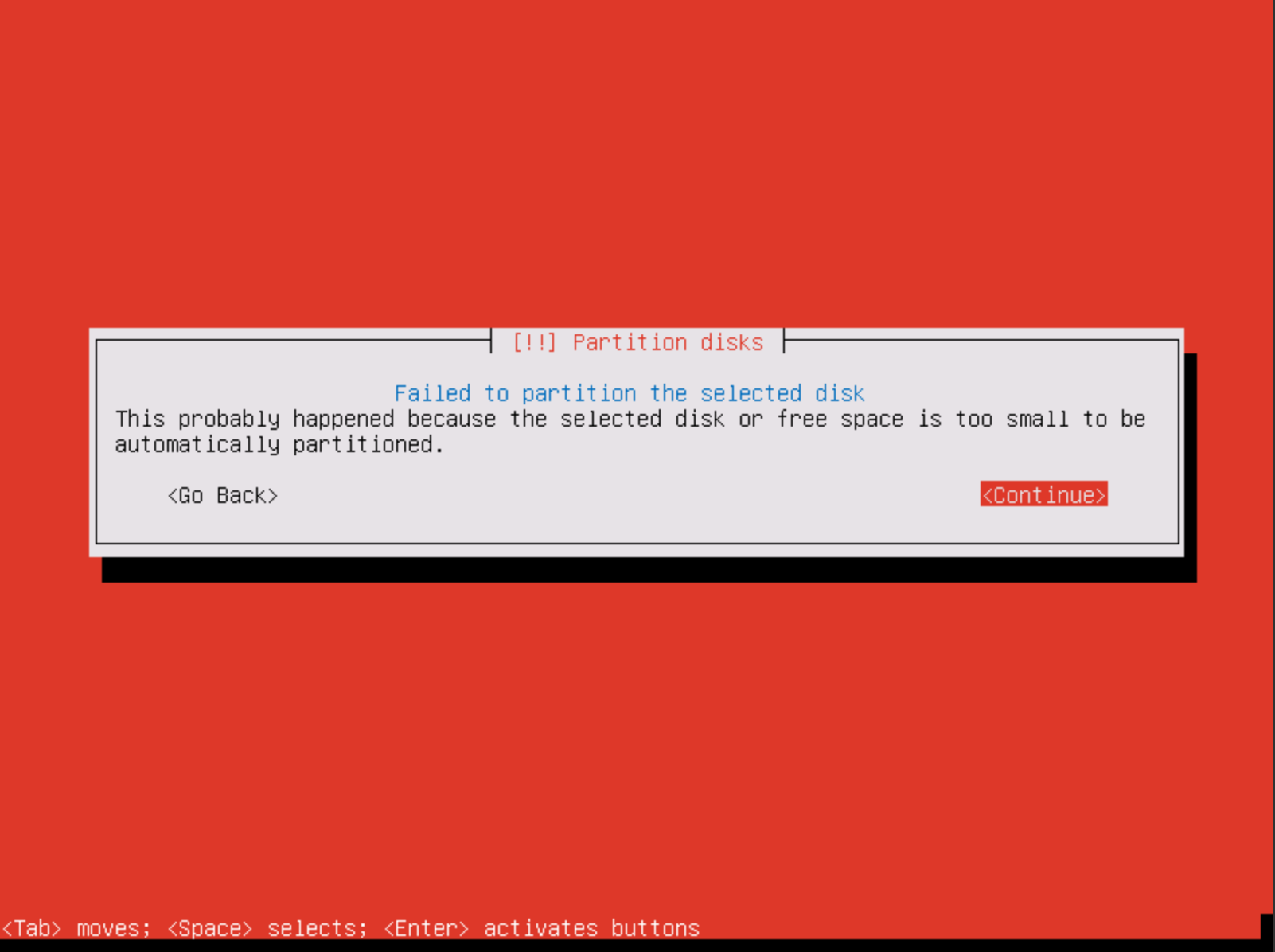

Error Installing Ubuntu 14.04?
Using the Ubuntu template I can't seem to complete an install.
I get to disk partitioning and I get the error:
"failed to partition selected disk" with no apparent way to mitigate it. I have tried swapping bios types, bumping the disk size to 1G etc but no joy.
Anyone else having this issue?
So I grabbed a CentOS ISO and it had the same issues. The installers can't seem to actually access the virtual disk for some reason.
Any pointers would be appreciated, I am sure I am missing something obvious. However I have explored all the options I can seem to find for the VM.

If you post your XML it might be easier to help you.
Sure! Below is the complete XML. I am attempting to install Ubuntu server LTS 14.04. I am not doing anything special or strange in the install (like changing default FS type or anything).
I have also attached a screenshot of the exact error.

How big is your vdisk1.img?  Sounds like you're running out of space...
I thought Ubuntu needed a minimum of 5GB
So I zapped the VM and recreated it with a 10G virtual disk and it installed fine... I knew it would be something painfully obvious like that. :/
Thanks!
