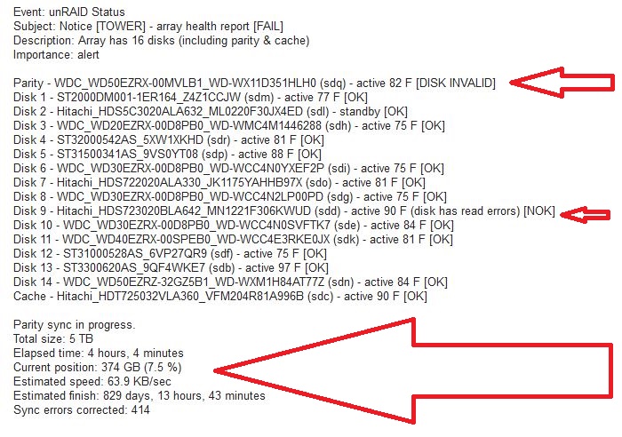

Guys I finally got all of my data backed up after an issue with an MB upgrade etc, I ran 2 preclear runs with the 5tb drive before swapping out with the 4tb i had in the system.
3 different times i have started a parity sync and it starts out around 35mb/s sec and then slows after a few minutes to 30 -60 kb/s.
1st time it went to 1.5% then next time it went to 5% , now this time at 7.5% , I noticed disk 9 has a few sector errors and i could remove it from the system if need be, Do you think disk 9 is the reason for the slow parity check?
for the times it stalls like this the webui is not locked up but definetly is really slow and will let me cancel the parity sync, but it sits for ever after i try to shutdown, and a couple of times ive had to hold the power button!
I have attached a health report let me know what you think i should do?
thanks

A log may show more details, but what you posted likely gives enough info to isolate the issue ==>  You have a failed drive (Disk #9) that is causing the sync to slow to a crawl ... and you don't have good parity, so you're not going to be able to re-build that data.
I'd stop the parity sync;  see if you can at least read Disk #9 well enough to get a directory of what's on it [save this if you can get it];  then do a New Config, assigning all of the other drives and your parity disk -- but NOT #9; and then you should be able to do a successful parity sync, so at least the rest of the array will be protected.
Then you'll need to reload all of the data that was on Disk #9 from your backups ... or if you don't have current backups you can attempt to recover what you can from that disk -- preferably using another computer, although you may be able to mount it outside the array and do this on the UnRAID server.

Just noticed that you do indeed have good backups ... so the only real question is whether or not you can read a directory of #9 so you know just what you need to restore.
Gary - cooking dinner right now , but stopped by the win 10 pc and grabbed the log , check it out yes i beleive your right on with disk 9 being the issue, I will do as you say...
