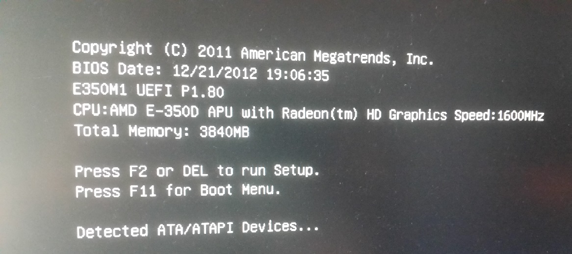

Thank you for the swift reply.
The odd thing is that none of my drives are being shown in the POST (Picture attached) from here it just jumps to the unRaid boot screen.
I've just updated the BIOS on my motherboard, still no luck.
Next step I'll check if the sata controller is detectable in another system
!UPDATE! SATA controller is DOA, it didn't show on my other system aswell.
It turned out it was a bad card.
