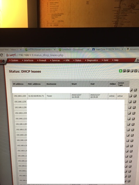

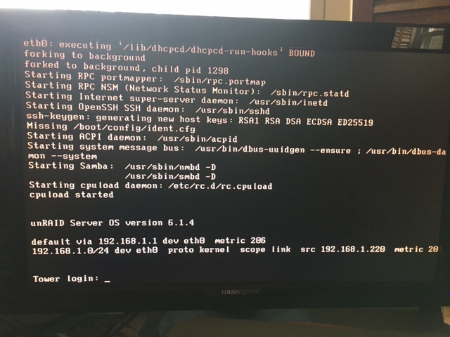

Are you sure you tried the correct IP address. The IP in the screen image is not the IP in your post (which is not a valid IP in any case).

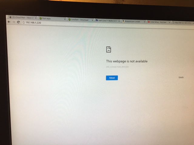

thanks for the response, no i cant loggin on mac, win, ubuntu... i get this every time "This webpage is not available"

here what the router says for ip

There are 3 pictures in this thread from the original poster. Do you mean the picture in the first post? It should not be necessary to login to the console. I run headless and almost never login to the console. I just use the webUI and occasionally telnet for some command line stuff.
