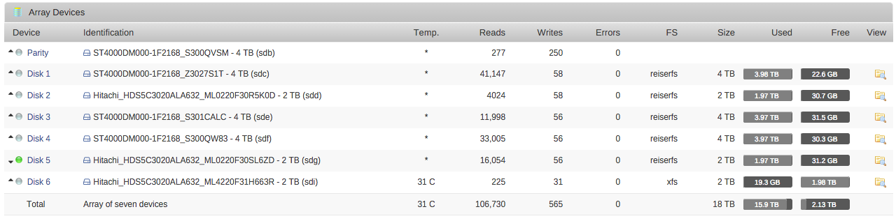

i got a small problem here with the S3 Sleep Plugin. I am using unRaid 6.1.6 with the newest S3 Sleep Plugin.
Since i added a new disk the server wont sleep anymore.
When i turn on debug mode i see that the Script thinks that the disk is still busy: "Disk activity on going: sdi".
The unRaid Webgui shows the disk as spun-down but the temperature is displayed.
The disk is not connected to the Motherboards Sata Ports but a simple two Port ASM1061 controller card.
I know that this could cause the problem, but why does the unRaid Webgui see the disk as spun down but the S3 Sleep script does not?
