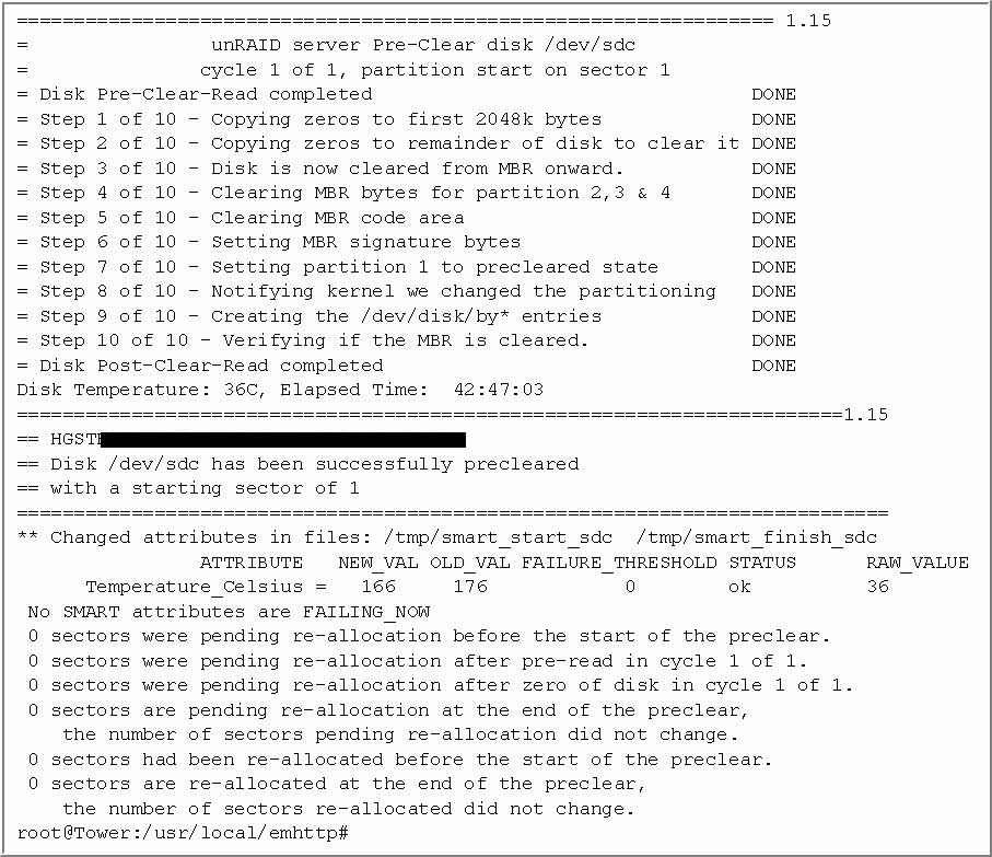

The pre-clear of the new parity drive (4TB) seemed to go fine (see screenshot).  So what is the best process for adding the new parity drive (4TB), while also reassigning the old parity drive (2TB) to a data drive slot?
Forgot to say that it's always good to check the preclear log, make sure pending and reallocated sectors stayed at 0.
Thanks.  I think its ok (see screenshot).
