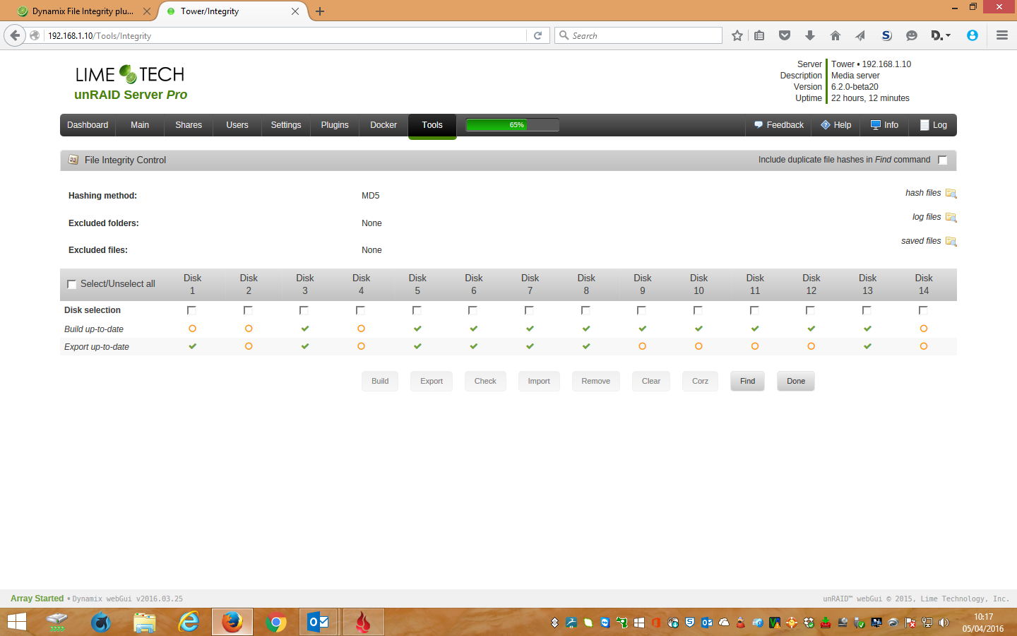

My main concern now is the FIND feature.  This is using a significant portion of my CPU when I am not wanting to do anything with finding duplicates.
When you open the integrity control page it will start every 3 minutes a background job which is used to update the status of build and export of each disk. This is unrelated to the find command.
You can check if the background job has issues by running it in the CLI:
/etc/cron.daily/exportrotate -q

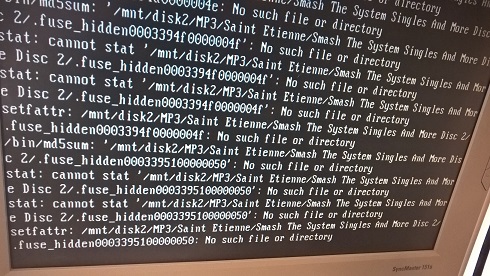

Any suggestions why 2 of my disks need to rebuilt every day?  Possibly I have to many files for innotify?  I have a few million files (due to plex app data daily backups)
I am pretty sure I figured this out with a lot of testing.  I'm running rsnapshot sync each night to backup my appdata folder to my array.  This is not getting picked up by the plugin.  Why though.  I am not sure.  This is run directly on unraid via cron.  Its not within a plugin.  Maybe that's it?
I'm going to try excluding this folder tonight and see if it fixed the unbuilt disk.
This solved it.  It seems that anything transfered with rsnapshot sync is not getting picked up by the plugin.

Just for more information, I have now revcieved a notication that Disks 2 & 14 need to be built and exported, from your earlier post I understand that messages shouldn't be sent about build after the intial build has been carried out. However I assume this message was issued as I have turned off the ceration / verification of hash file?
Event: Dynamix file integrity daily update
Subject: Notice [TOWER] - Disk 2, Disk 4, Disk 14 needs Build & Export updating
Description: 19 new files without hash value
Importance: normal

The second problem, as below occured due to ign files that do not appear to exist, which I am not sure are connected to the use of the plugin.
stat: cannot stat '  /mnt/disk2/Hi Def 2/The Big Bang Theory/Series 6/mymovies.ing : No such file or directory
/bin/md5sum: ' /mnt/disk2/Hi Def 2 /The Big Bang Theory/Series 6/mymovies.ign' : No such file or directory
Please excuse my OCD-like observations.  When you first posted the lines above, there were so many typos, I didn't know what to say.  I realize typos don't matter to some, but as a programmer, I can't help noticing them, because they are critical.  So I can't tell if they were introduced by hand typing the error messages, or are actually correct quotes.  If so, they do explain the error messages.  I'll just list them, you can decide if they're an issue -
* stat: cannot stat '  /mnt/disk2/Hi Def 2/The Big Bang Theory/Series 6/mymovies.ing : No such file or directory
- 2 spaces after the leading apostrophe, can't be correct
- file extension is .ing, is that correct?
* /bin/md5sum: ' /mnt/disk2/Hi Def 2 /The Big Bang Theory/Series 6/mymovies.ign' : No such file or directory
- 1 space after the leading apostrophe, can't be correct
- has "Hi Def 2 " (extra space after the 2) instead of "Hi Def 2", both can't be correct
- file extension is .ign, should it be .ign or .ing?
Sorry, some of us are just annoying purists.  But without accurate info, it's hard to help.

I was copying from a monitor attached to the array, it appears that I made some typo's

Good timing on the update as I came here to ask for assistance with this. The mover just grabbed a whole pile of rar part files and everything got real slow.
I have now taken my Unraid array (6.2b19) back to the basic install
I have installed the latest version of the plugin, build & exported all drives, and set it automatically monitor new / changed files. I have also added the cache directories plugin + Plex docker.
Everything appears to be working on OK, but I have two entries shown on a monitor attached to the array which read:-
