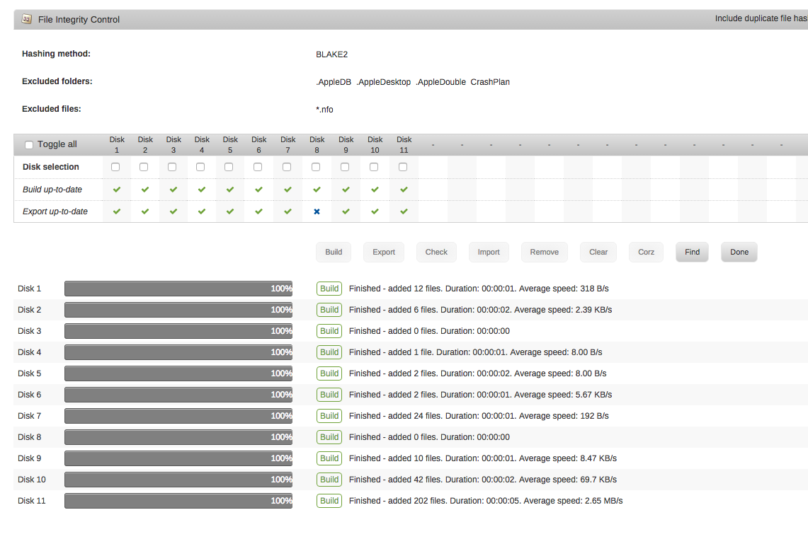

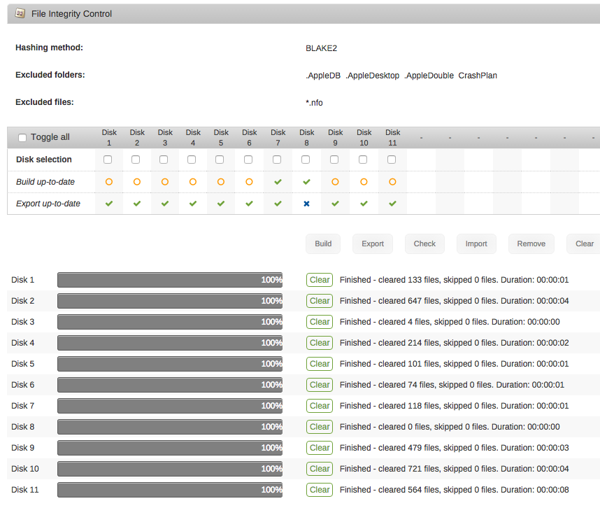

Edit: Ok, I've done a LOT more testing and I'm nearly certain that there's a serious problem with this plugin, at least in my setup.  I took the following steps:
1) Run a build on all disks.  All show green checks.
2) Export all disks to check for excluded files.  All disks still have green checks.
3) Clear all disks.  Hundreds of files cleared since last clear operation yesterday.  All disks still have green checks.

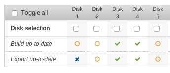

4) Once the clear operation is complete, almost all disks show they need built (see screenshot).
5) Run build again.  Hundreds of new files hashed (see screenshot).  Between #1 and this step the array was idle.
I can then alternate between building and clearing, back-to-back, with hashes being added and cleared with every operation.  It seems like the Build and Clear operations are not using the same exclusion lists.

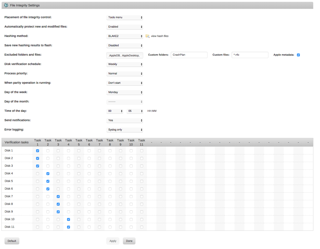

Here is a copy&paste of my settings (files to be excluded):
*.nfo,*.dump,*.xml
....maybe a space after each file pattern  is missing? I have also cleared all disks according to your guidance ("After a Clear command, do an Export and verify if any excluded files and folders are still present in the exported file(s)") but still see some of these files.
I also enabled automatic hashing but each morning the system is showing a similar picture as shown below.
