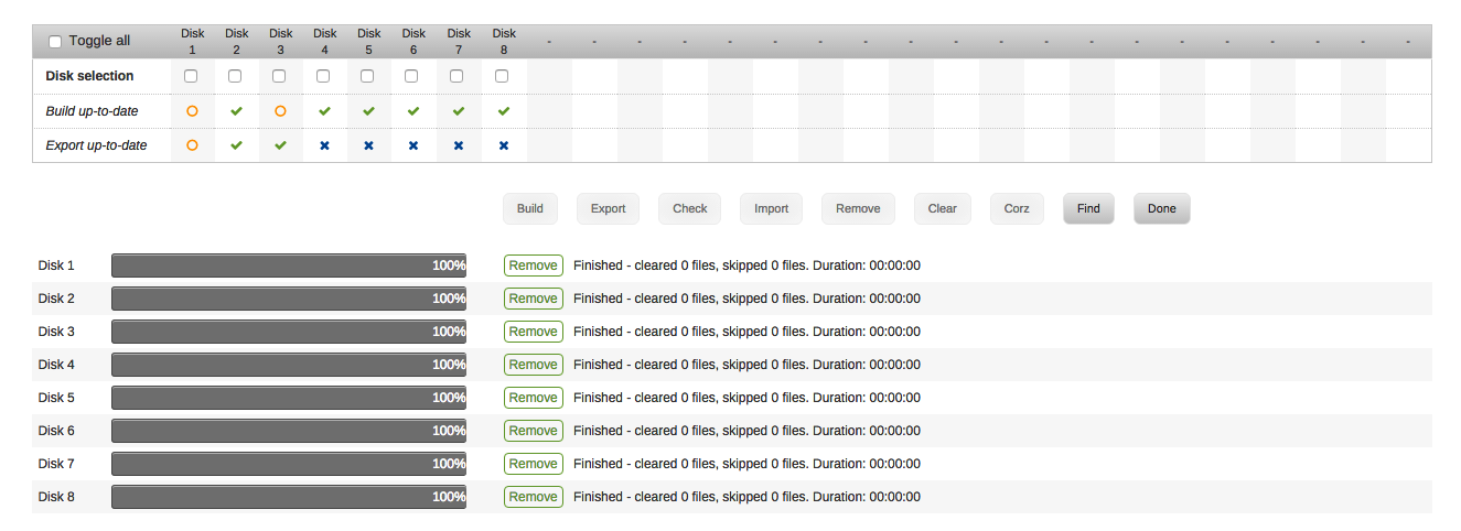

When you start the plugin does it not protect old files already on the array? I just noticed in settings were you enable it that is says "Automatically protect new and modified files". IF so that is probably why there was a difference in what it was scanning and what was actually on the disc. :/
Is there a ways to hash old files? I uninstalled the plugin, deleted it's folder on flash, and re installed. Is there anything else i should do before i enable it again? Should i even bother now? heh :(
It uses inotify to let it know when a file is new or modified so it can hash them. Turn on Help for more instructions on how to get the old files hashed.
Is that the Build command?
So, should i select all my disks and run build, then enable Automatically protect new and modified files after it is done? Do you recommend i do anything else?
Sorry, this is all a bit confusing to me and i'd like to do it right this time :/
EDIT: No more time to fiddle today. Hope i did it right hehe

Also.. with my settings two posts above it no longer hashes anything automatically. I get notifications to build export manually. Can anyone help me get this working for good? :/
Upon first installation you need to Build to get all hash values calculated. It is recommended to exclude any folders and files which change regularly (normal disk protection works here).
I did a build after install. As shown in the pics above. It does not hash anything automatically. I get notifications to build / export manually.

No idea why its not hashing new stuff then :(
All i did was re-install. Set those settings above. Build and export.. What did i do wrong?
