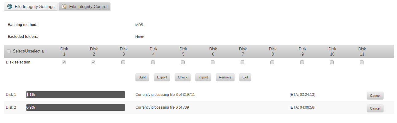

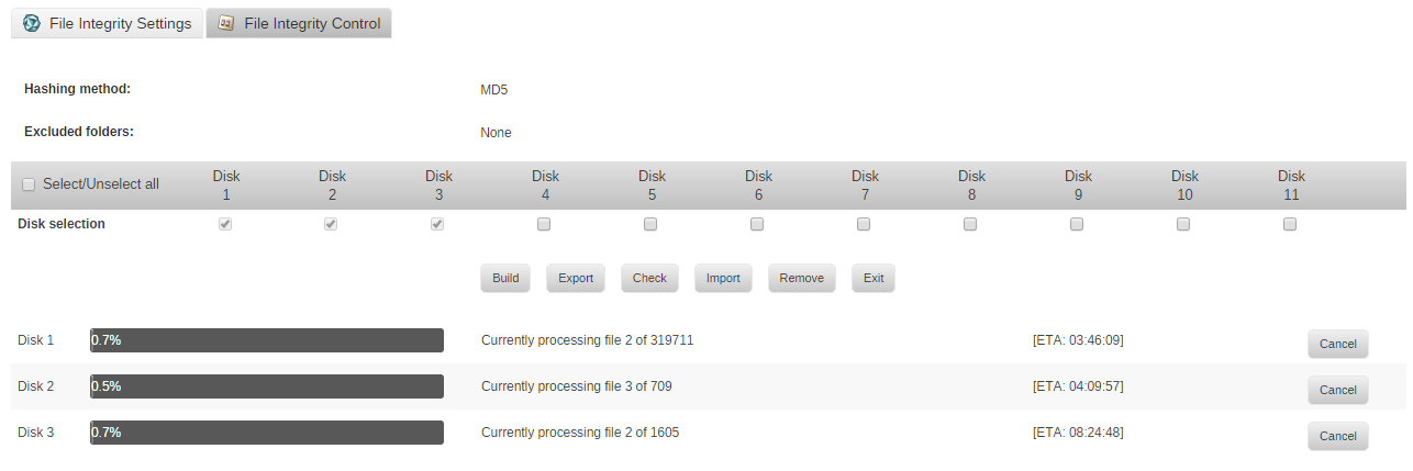

Started 3 build operations for disks 1, 2 and 3 (see first picture)
After a few minutes canceled disk 3, both disk 1 and 2 continue to work (see second picture)

Can o please repeat your test but canceling  disk1 instead of 3?  I'm not close to a server right now but I believe it didn't happened if I canceled the last disk.
Good catch, canceling the first disk 1 gives your situation. :P
Let me check and correct that ...
Nice to know I'm not imagining things ;)
Thanks for looking into it.
Made a correction and fixed the incorrect display update when a running disk operation is canceled. There is a mistake corrected too in the process termination logic (it didn't always find the corresponding pid).
Please update to version 2016.01.01b if you want to use the Cancel functionality on the control page.
