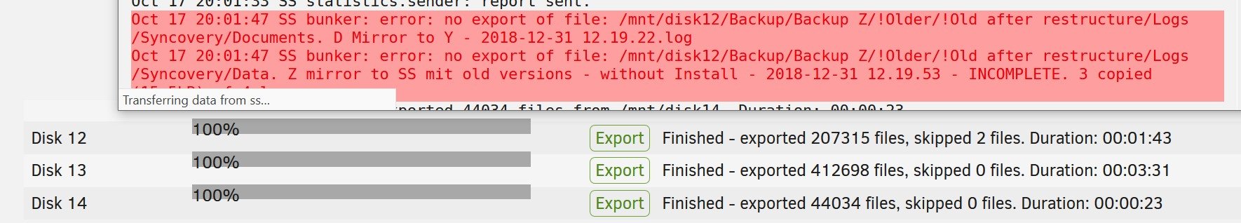

I have two disks with 1 and 2 files that fail to export. I understand that an export failure is due to the fact that no hash has been generated for them. I (re)Build both drive but the error still persists. Here is one example:
xfs_repair (without -n) did not do anything either.
All files and can be read and copied without problems and are identical to their sources.
Note, though, that the folder has actually a whopping 25000+ file in it.
When I ran into this problem I had thousands of export errors on several drives. After Build, I am down to those three.
I also noticed that the number of files that were reported as having an export error was not identical to the ones that are reported as added when I run the Build. Added is higher. I would have expected it to be the same. E.g. Export = cannot find the hash <=> Build = adding the hash.
Appreciate your advice how to judge this and which measure to take to either assess more or rectify.
Thanks!
Long story short, the error not means filesystem fault, it should bacause file have extended attribute but in exclude filter and cause conflict.
An way for clear those error was use "clear" and "remove" function to clear the dirty data ( extended attribute ).
For example,
BUILD -> CLEAR -> EXPORT -> REMOVE -> IMPORT ( Pls backup all hash export file first )
Some feedback for FIP, for my understanding this plugin just call "bunker" and "bunker" like a blackbox, so any problem/bug in bunker can't fix by this plugin.
Edited by Benson
