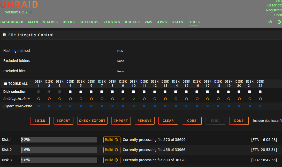

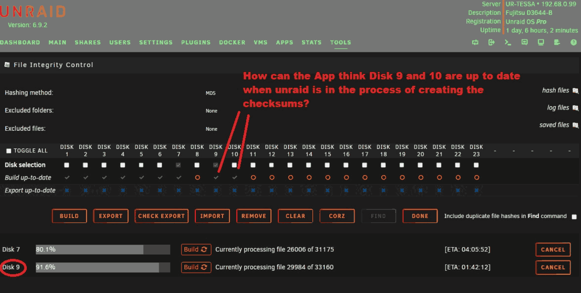

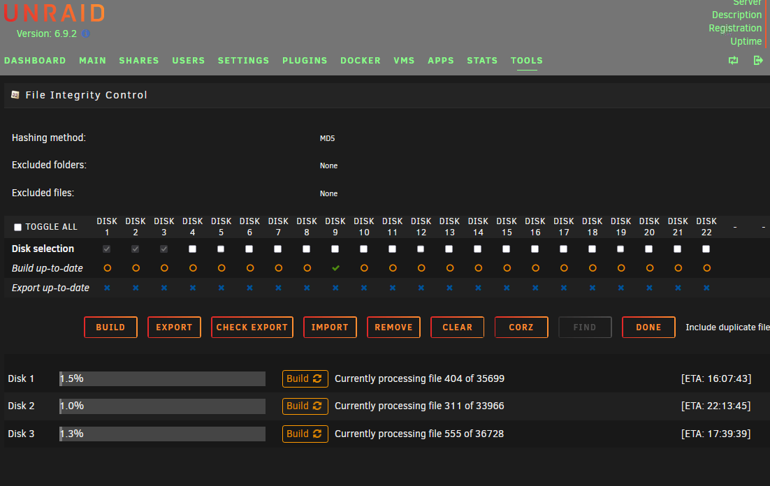

Hello @bonienl
I am a newbie/beginner (and not native english speaking).
I installed this Plugin.
I build md5 on several Disks (1 to 12).
Then I read that Blake3 should be faster.
I stopped creating md5, switched to Blake3 and Build new on several Disks.
Since I did not experience faster building or less CPU usage, I stopped it, removed the Hashes, switched back to md5 and started to build anew on those disks starting with Disks 1,2 and 3.
But surprise!
On two disks (9 and 10) the green sign for (up to date) appeared.
I removed the hashes on 9 and 10 again, the green sign switched to the orange circle...only to appear again after several minutes.
I removed the hashes again, the green signs became orange circkes again.
And serveral minutes later the green sign appears again (this time only on Disk 9).
I do not understand what I am making wrong.
(Adding another Screenshot: several minutaes later Disk 10 also did get the green sign again. I am puzzled. Addin third Screenshot from a newer bulding. Still 9 and 10 have the green sign. Even when disk9 is just buiilding.).
Edited by DataCollector
adding second screenshot and smal text

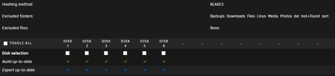

Hi there,
I have 2 disks.
Disk 1 has my Media share, Disk 2 has everything else.
I have had FIP running for a while now but recently selected my Media share to be excluded, via Settings -> FIP -> Excluded folders and files:
I have my Disk verification schedule to run monthly.
When my monthly Disk verification started running today, I noticed that it was reading from Disk 1, and in Tools -> FIP, I see that Disk 1 is currently processing file xxx of 88805, when I'm not expecting it to verify anything on Disk 1.
Is this because there are existing hashes from this share, since it wasn't excluded previously?
Thanks.
Yes, actually because the file hash entry in Disk_1 export file, so you can
- Delete Disk_1 export file
- Clear DIsk_1 file hash attribute then export to update

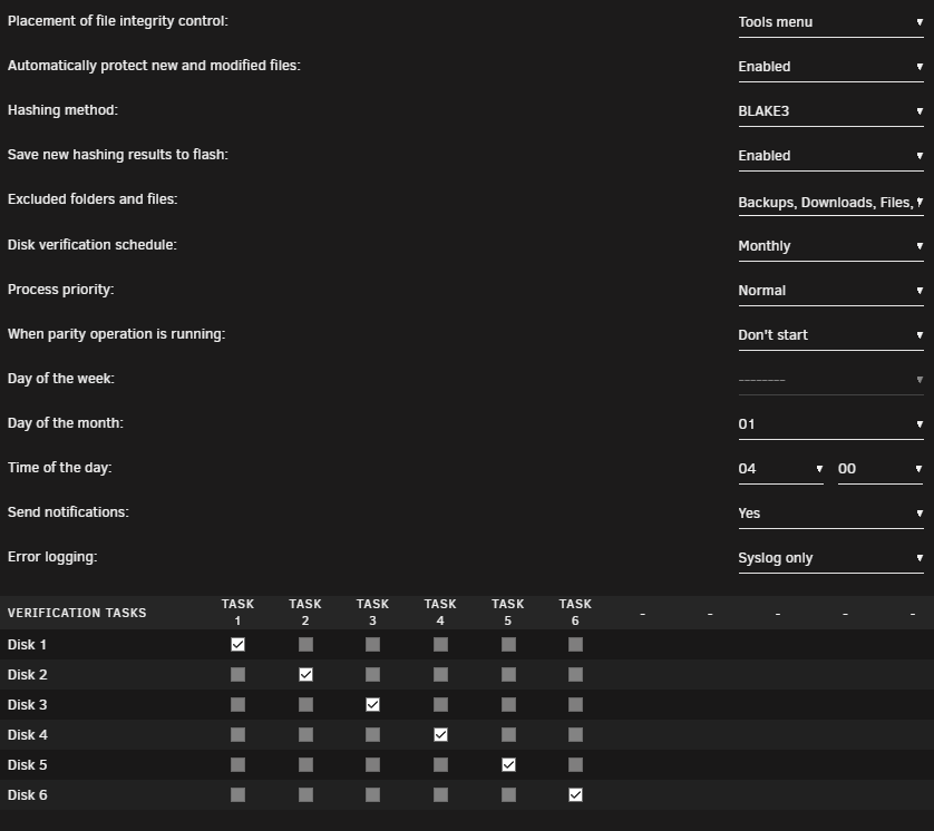

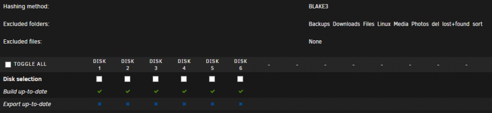

Hi. Just installed this plugin and configured it as such:
And then clicked "Build" with all disks selected:
Do I need to do anything else or will it automatically calculate hashes for new files (as they are created) and verify the existing ones (on monthly basis) on its own?
When ever I tried to schedule one to kick off daily in 15 minutes, it's only ever kicked off the check for Drive 3. It finished and nothing else started. *shrug*
I changed it from monthly to daily to check how it works and it only checked Disk 5.
So do I have to click "Build" every now and then manually and when I want to check validity: "Export" and "Check Export" also manually?
Seems like it.
Sometime last week, I set my Validation scheduled to weekly on Sunday. Disk 1 kicked off and completed but none of the others did.
I'm also wondering how does the Task function work. You can set up One drive per Task which seems the logical choice but you can also assign multiple drives to a single Task.
What exactly *is* as "Task" in this case? It seems like a single thread that will do stuff. There's no built-in help around it.
