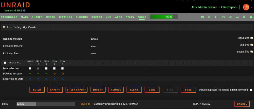

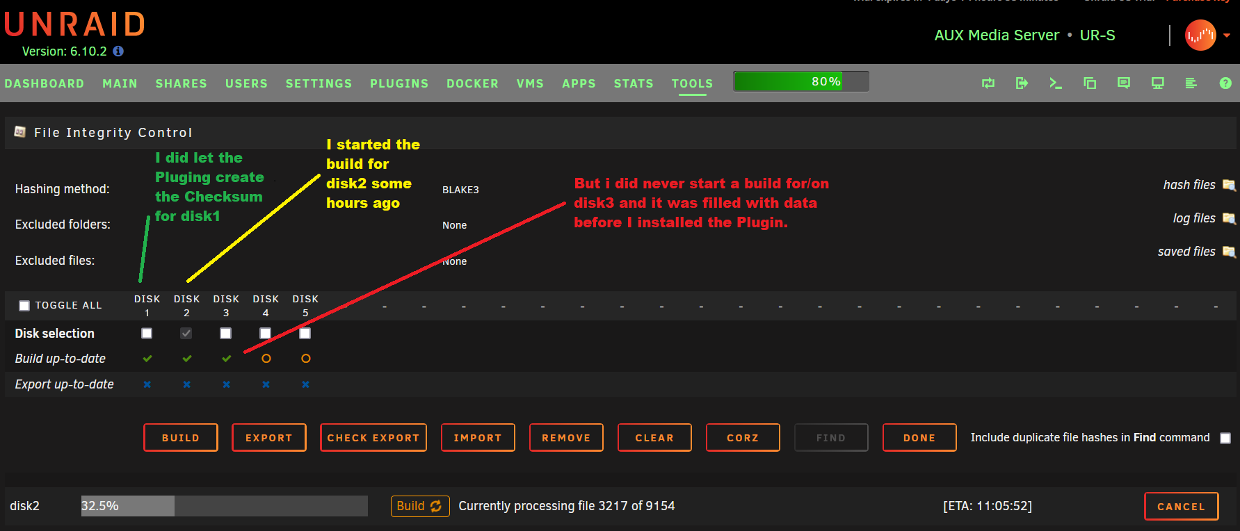

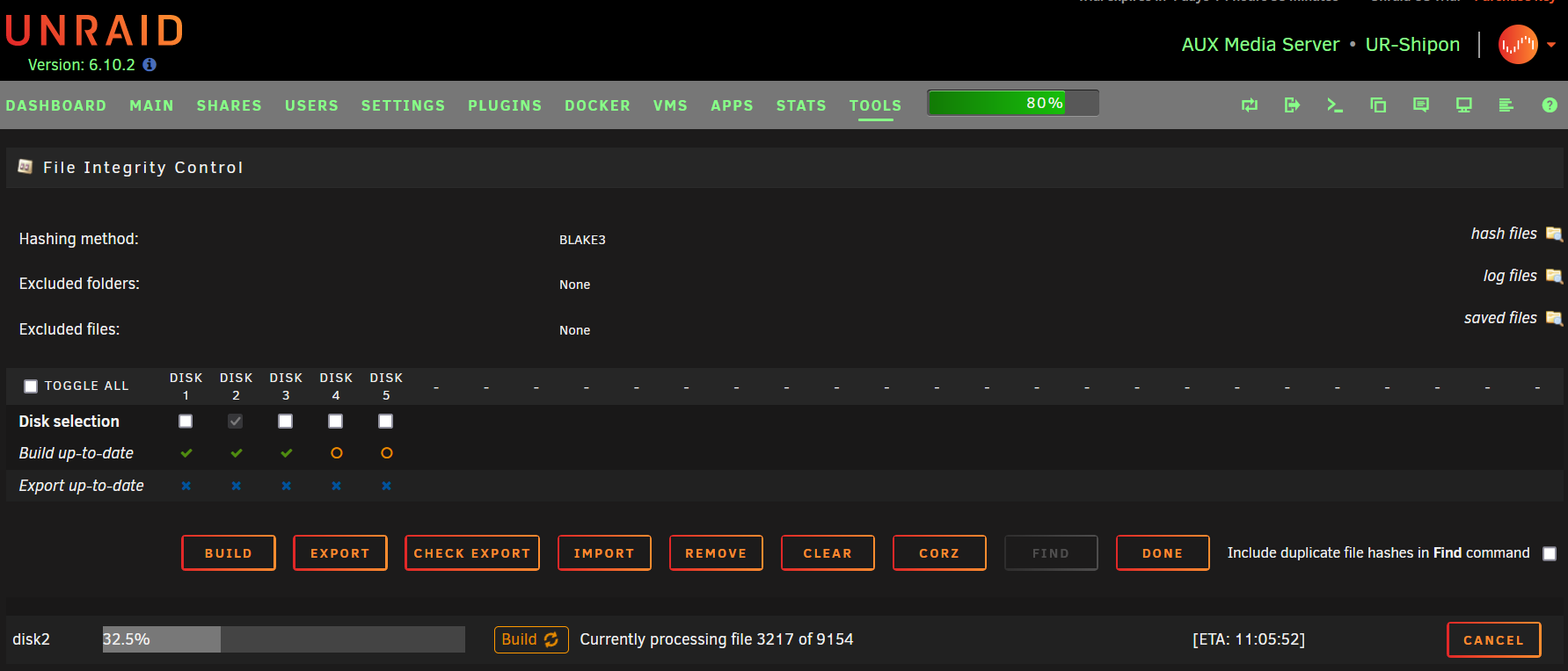

Hello.
I created a 2nd unraid PC completely new (from old parts).
I filled Disks with Data and then created Parity.
After that I did install the Plugin Dynamix File Integrity.
Then I checked disk1 and started Build on that disk.
So disk1 is the only one I started to build the checksums and none other on this machine up until now.
After Buiild for disk1 was ready I looked and was surprised:
Disk1, 2 and 3 have a green sign (Build up-to-date).
Since i did not build on Disk2, 3, 4 or 5    I am confused.
I now started Disk2 Build and this is now running.
But look at the Screenshot below:
The Tool tells me the Build on Disk1,2 and 3 are mentioned to be okay.
I did only create disk1 checksums and let it now bulild them on disk 2. I never build checksums on disks 3, 4 or 5.
I had this problem several Month ago (january 22) on my first unraid machine also and did uninstall the plugin.
Now on this (2nd) machine I have the same problem.
How can I trust the File Integrity Plugin, when it looks like it does not tell me the actual truth?
Where is my mistake?

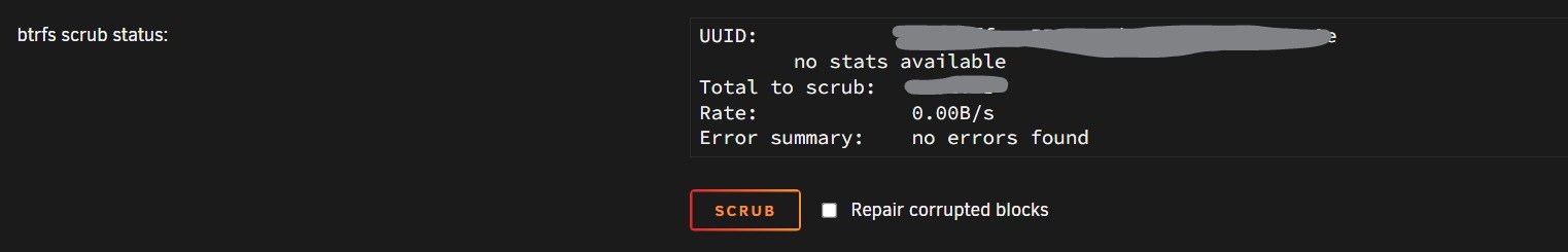

Hi. Im newbie here and I'm curious about this DYNAMIX FILE INTEGRITY PLUGIN vs Btrfs scrub.
I'm currently running BTRFS on 2 x 5TB data array with 1 Parity.
I read some discussion that the Btrfs scrub will compare the previous data checksum with the new checksum from new scheduled scrub job, then notify the error/Repair corrupted blocks. This function seems to be the same with the Dynamix File Integrity.
So my question is what's the different between those two methods ?
There are some suggestions that Repair corrupted Blocks function is not working/effective since there is no Raid in the array, therefore, if problem occurs with a disk, Repair Corrupted Blocks is useless and Btrfs scrub is no more than just a corruption alarm. So does parity disk help anything to repair the corrupted blocks ?
1195347382_Webcapture_7-7-2022_203036_192_168_50_105.thumb.jpeg.3768bf0151b016f3bc72c5f65e533ac0.jpeg
Thanks, everyone.
Edited by Ken.N
Correct, for array devices a btrfs scrub can only detected data checksum errors, it can't repair them since there's no redundancy, and no parity can't help with data, it can repair metadata errors since that is redundant.
Thanks, @JorgeB. for your reply. I would love to understand more about how parity works.
As I read some old threads in Unraid and as you clarified already, Parity can not help anything in bit-rot, bad sector situations and parity just simply helps recover data of one malfunction data disk (suppose only 1 parity disk) while other disks in an array MUST be healthy to participate in recovery.
So does this feature also create a consequence that when the data disk encounters data corrupted, the parity will also sync the wrong corrupted bit string and replace the good bit string of the previous parity-sync ? Is there any solution within Unraid array to protect array against bit-rot, bad-sector except off-side backup ? oh wait, even if I run off-side backup on Unraid OS, there still exists corruption potential as well.
If this is the case, Unraid eventually exists a drawback against Raid due to the fact that Unraid has no redundancy and can not protect data from corruption, while Raid does by discovering corruption by BTRFS scrub job and repair corruption by comparing bit strings among raid disks.
Please help me to clarify this. Much appreciated.
Edited by Ken.N
If there is bit-rot in a disk, which in my experience is extremely rare, and you run a correcting check parity will be incorrectly updated, note that we always recommend running non correcting checks unless sync errors are expected, like after an unclean shutdown for example, if sync errors are found without a known reason and the user has checksums for the data disks he can then first check those and then decide how to proceed.
Depends on how you do the backups, I for example use btrfs send/receive to backup all my array disks 1 to 1, the stream is checksummed all the way, if there's a checksum error on read it will abort, and as far as I understand the sent metadata also includes the checksums.
22 minutes ago, Ken.N said:
If this is the case, Unraid eventually exists a drawback against Raid due to the fact that Unraid has no redundant and can not protect data from corruption, while Raid does.
Usually you cannot have just the benefits of something, Unraid is very flexible with for example using the full capacity of different disks sizes, recovering the data from the remaining disks if you lose more disks that redundancy can save, but there are also some drawbacks, like array speed and array bit-rot fix, there are the pools where can have redundancy, but btrfs raid5/6 is not stable enough for the typical user and raid1/10 is not very efficient for large pools, soon you'll be able to create a zfs pool, of course you'll lose some of Unraid array advantages, like can't fully use different size disks with raidz and you can lose the complete pool if more disks than current redundancy can support are lost, again you cannot have everything.
Oh yeah for sure I understand this point. Everything has two sides and your clarification even still strengthens my decision of choosing Unraid rather than other OS. Knowing how Unraid works will help me and everyone have further implementation to avoid unpredictable lost down the road. Thanks, cap. @JorgeB
