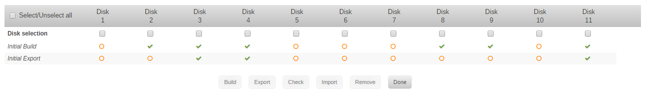

SMALL feature request for future bumps... a flag indicating if an initial build and a flag indicating an export has been accomplished per disk.
Good idea, but I need to work out how to do this in a reliable way.
perhaps write a CSV file to the flash that is read each time the gui page is accessed?
Have created the following, see the attached picture.
For all disks it will show whether an initial build and/or an initial export was done. A green check means yes, while an orange circle means no.
Useful ?

Yes, I think it looks nice and adds value.
For those interested, version 2016.01.06a is available now, see release notes.

Just updated and saw that my disks have the orange circle. To clarify, will they always be a circle upon a refresh reboot of the server?
No, once a build or export is done, this will change into a check symbol. This information is kept on flash in the file /boot/config/plugins/dynamix.file.integrity/disks.ini

There's something I may have misunderstood, so I'm running my tests again, regarding my .DS_Store problem.
Can I just check something, please? Under the File Integrity Control tab, am I right in thinking that the Check button initiates a check of the files against their exported checksums and not against the checksums stored in the extended attributes and it isn't a manual equivalent of the scheduled daily/weekly check, which does use the extended attributes? If I am right, then what is the result of clicking the Check button without ever clicking the Export button? Could that explain the "bunker: warning: is missing" messages in my syslog?
I've stopped adding files to my shares for the time being and I've run Build again, and then Export. My disks now have both Initial Build and Initial Export green checks. I'm running Check at the moment and hope to see no errors this time.
Nice plugin, btw :) Many thanks.
EDIT: The manual check has completed with no errors reported. I'll use the server as normal and see if any errors are reported after the scheduled check on Sunday.
