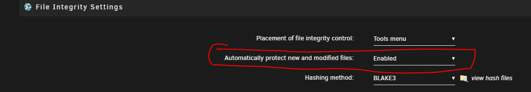

2 hours ago, Mainfrezzer said:
could it be that this is enabled? if so, it will automatically hash new files and then its just natural that the build is up to date.
Yes, I have Enabled "Automatic protect new and modified files".  I don't actually understand why you wouldn't have this Enabled, if you're trying to identify the integrity of the files on your system.  Otherwise, any new / changed files would presumably not be included?
Are you suggesting that by Enabling this setting it then disregards the fact that all of the existing files have not yet had a hash built as yet?  This doesn't really make any sense to me.   If this was the case, the option should be called: "ONLY protect new and modified files".
Also, I hadn't added or modified any files on the disks that it decided were now "build up-to-date" on (even though I hadn't done an initial manual 'Build' yet).
Perplexing...

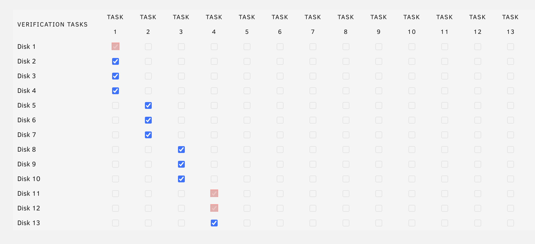

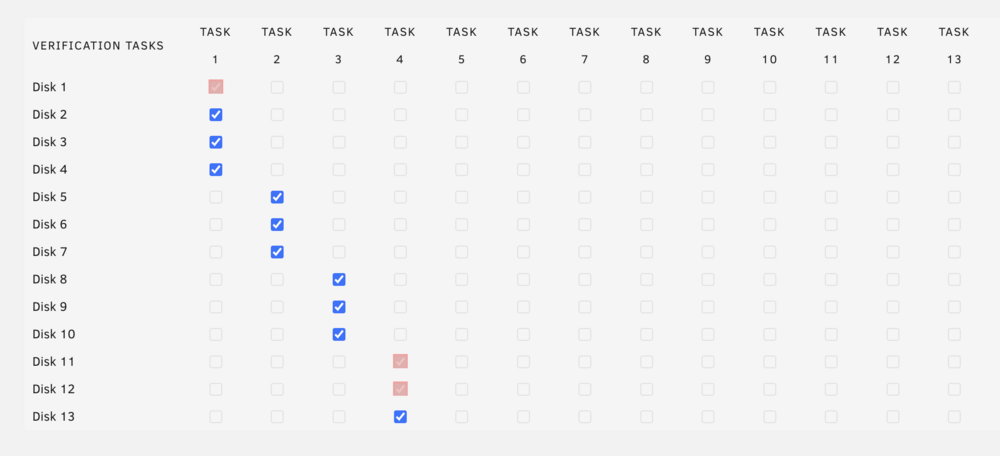

Yet more weirdness, that defies my logical understanding of this plugin...
I setup the verification schedule, as per the help instructions.
i.e. Specifically: "When multiple tasks exist then each task is executed in the next schedule in a rotating fashion. "
I put Disks 1 - 4 in TASK 1, Disks 5 - 7 in TASK 2 etc. etc. (as below).
I then expected the first weekly schedule run to do disks 1 - 4 (TASK 1), as per the help.  Then next week would be Diisks 5 - 7 (in TASK 2), etc.
However, the first scheduled verification has just started and it is currently working on Disk 11 & 12 (from TASK 4), and also showing Disk 1 (from TASK 1), is also in progress!
But, it also has only notified me that Disks 11 & 12 are running, but the below also shows Disk 1 as a (presumably) "in progress" coloured box???
I mean, WTF?   How is this verification schedule really supposed to work?  Does anything work as it's supposed to?
Edited by KoolKiwiNZ

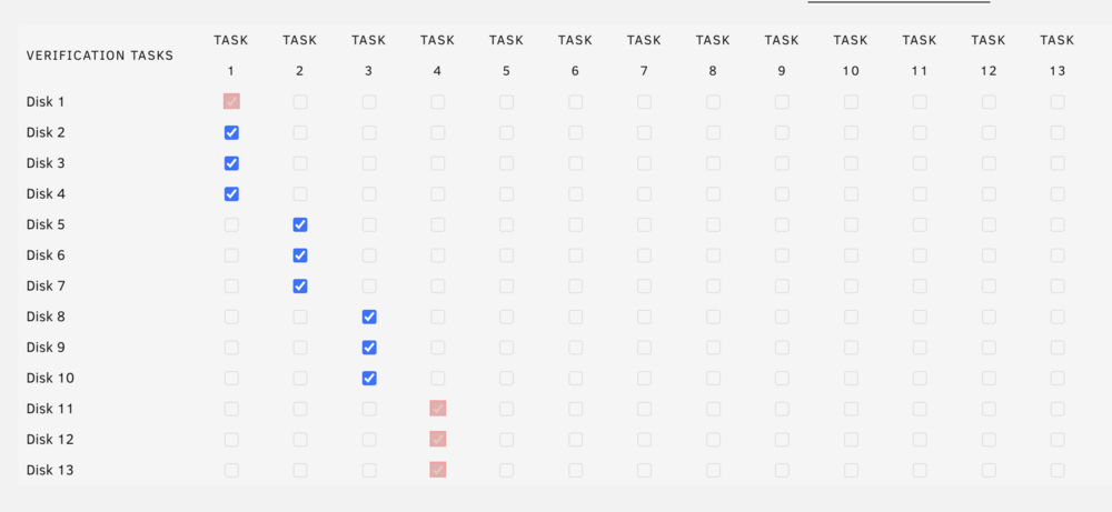

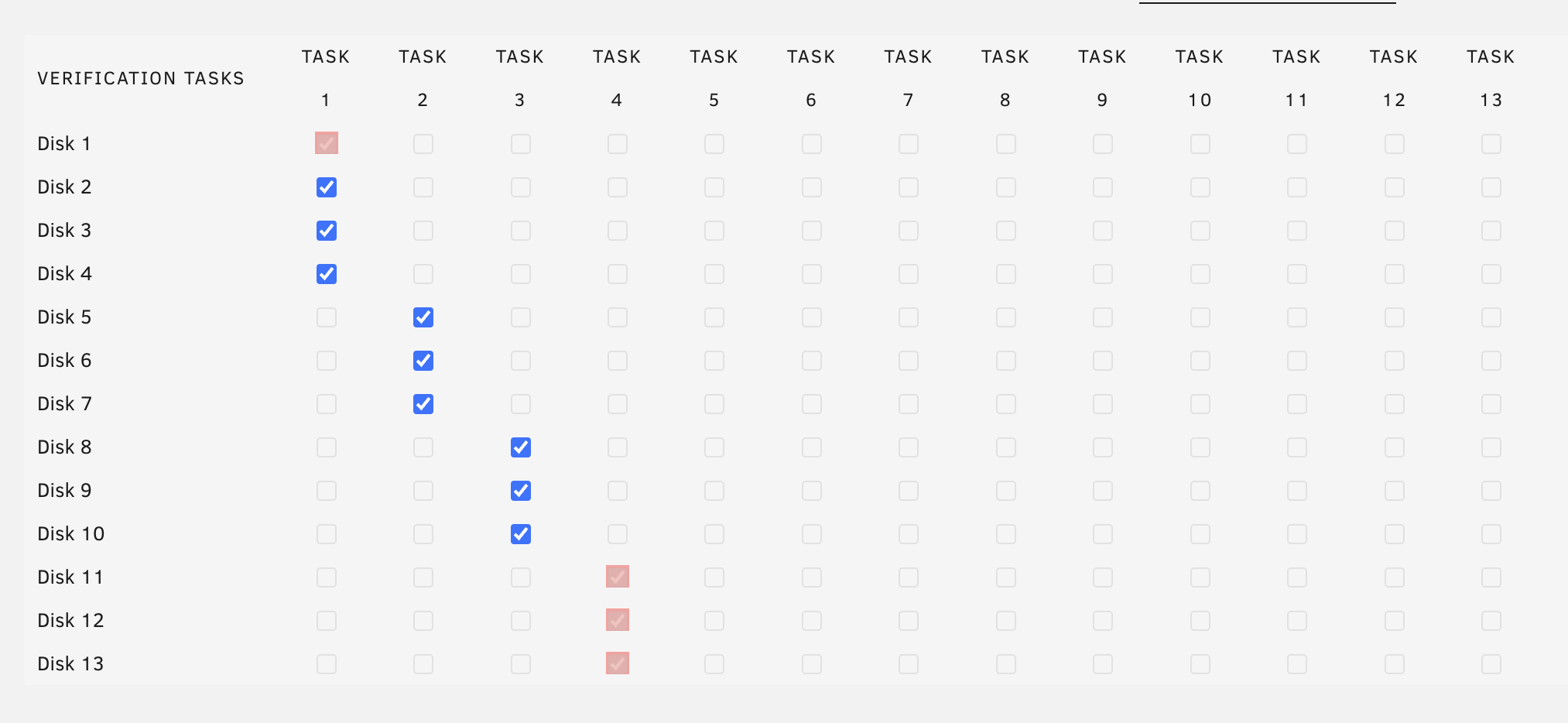

So, I thought I'd setup my verification schedule so that the second scheduled verification would kick-off.
The thinking was that since the first verififcation run seemed to do TASK 4 (for some reason), that maybe the next (2nd) verification run, would wrap around to doing TASK 1 (Disks 1 - 4)?
But, NO.  Instead the 2nd verification scheduled run is again doing TASK 4, so my disks 11 - 13 are getting verified once again.
In addition, while it's running, the Settings page is once again showing an activity on Disk 1 (in TASK 1), even though Disk 1 is not being verified.  According to the notifications only Disks 11 - 13 are being verified.
So, I have no idea:
a).  Why TASK 4 is once again being run (instead of wrapping around to do TASK 1 next).
b).  Why Disk 1 (scheduled in TASK 1) icon in Settings, appears to be showing it has some verification activity?
Here's the verification TASK schedule screenshot, which verification of TASK 4 (Disks 11 - 13) is again in progress (and showing Disk 1 seems to also indicate activity?):
Yes, I am still persevering with this plugin, even though I'm yet to find anything that does what I'd expected it to do!

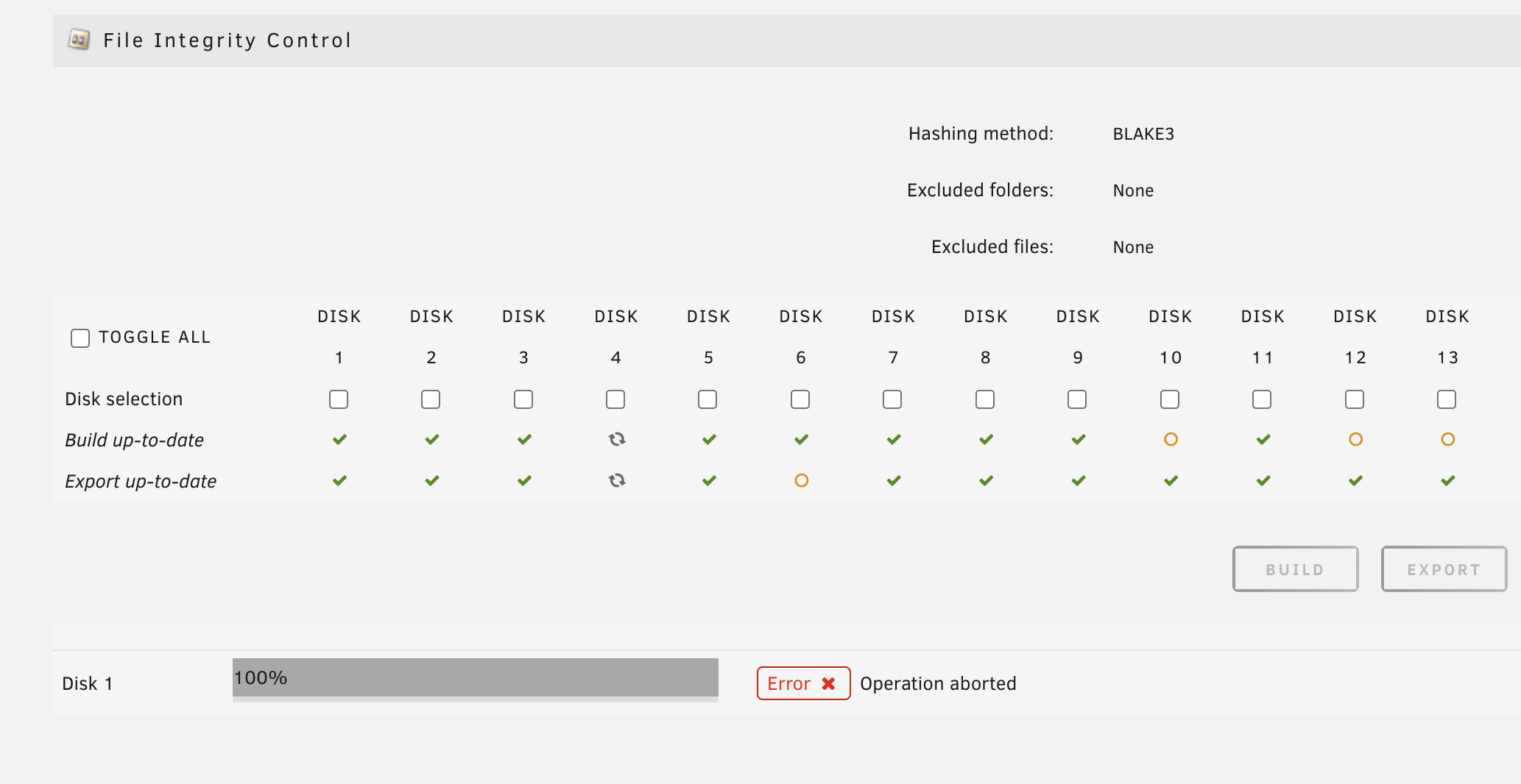

So, my first attempt at moving some new files to the server...  and you guessed it... more questions.
The mover moved some new files onto Disk 6.
But when I now go to the "Integrity" page, I get the below!
Why "Error Operation aborted" on Disk 1 ??   What Operation?  What Error?   Nothing in the logs!
Also: Why have Disks 10, 12, and 13 now lost their 'Build up-to-date' green ticks, when there have been NO write activity on these disks?  Do I need to build them again?
