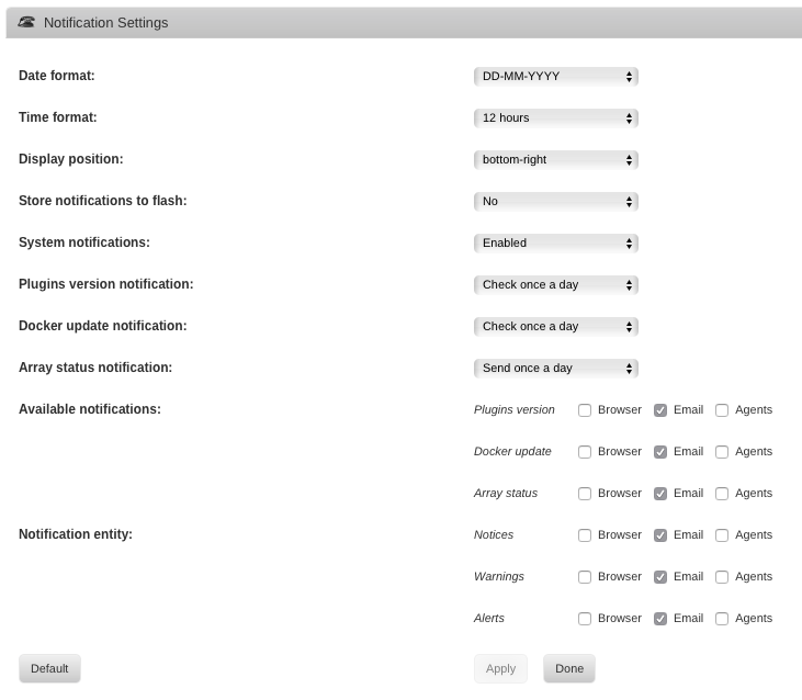

Which of course is the log of the 59,472 errors I have now noted in the GUI. Interesting that I had no Warning from unRAID as to these errors (but anyway thats a discussion for another day).
When Array status notification is enabled it will generate a report at the given interval and gives a warning notification when disks have read errors.
Footnote: System notifications need to be enabled in the first place to receive notifications  ;D
Sorry, it turns out I DID get an email about the errors. My notification settings are spot on and are clearly working. I did only get 1 notification email though, but I assume this is due to the frequency these error reports are sent via email. Would be stupid to send them every time there was 1 error. LOL - 57k emails!  ;)

... Would be stupid to send them every time there was 1 error. LOL - 57k emails!  ;)
If you don't get tired in receiving emails, you can up the status check frequency to every hour ;)
