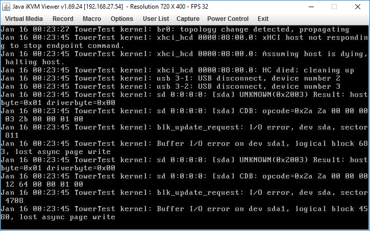

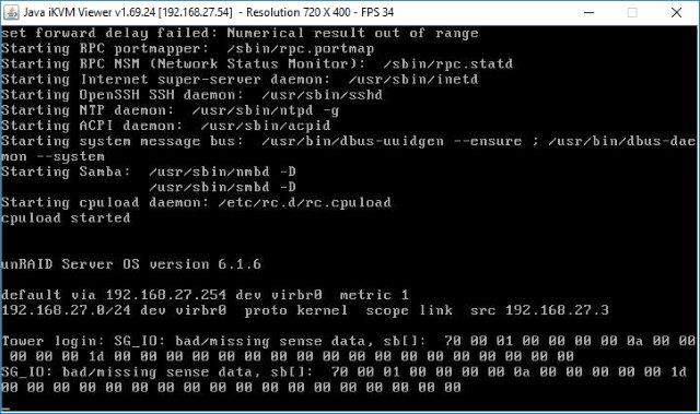

I've also attached the IPMI screenshot. It shows "bad/missing sense data". I am not sure whether this happened at the time of the crash, or beforehand.

System has been running fine for 2 days. Just now I went to stop a VM, and the host crashed after a few seconds.
After a reboot, starting and stopping VMs works fine. Just after some time I have the problem.
Here is dmesg. It seems to show some issues with one of the SSDs but I'm not sure if that is because of the crash, or causing the crash.

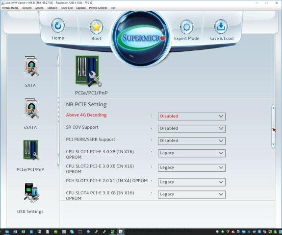

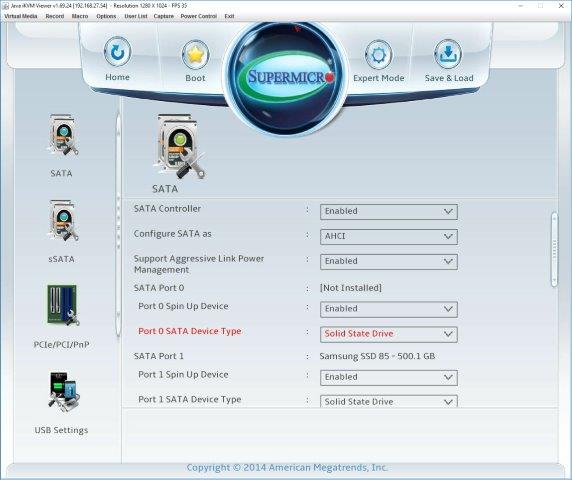

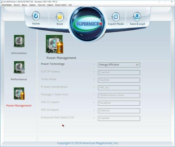

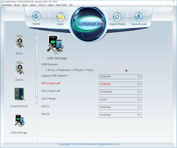

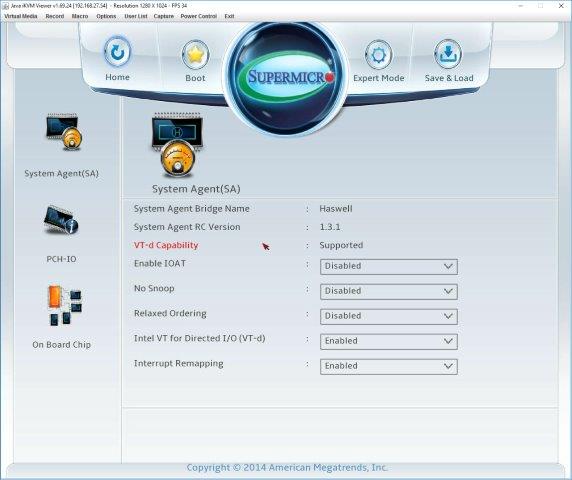

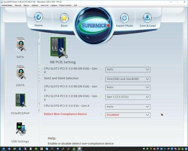

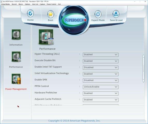

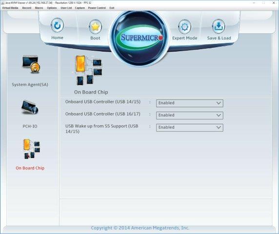

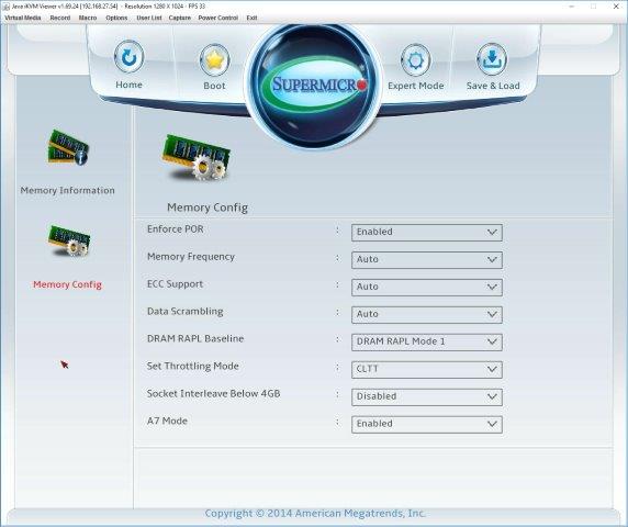

Here are the bios settings, anyone see any problems, or have any other suggestions. It is very frustrating having an expensive machine sat in bits not able to use it.
Thanks for any suggestions.
more bios pics
more bios pics

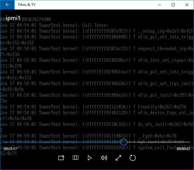

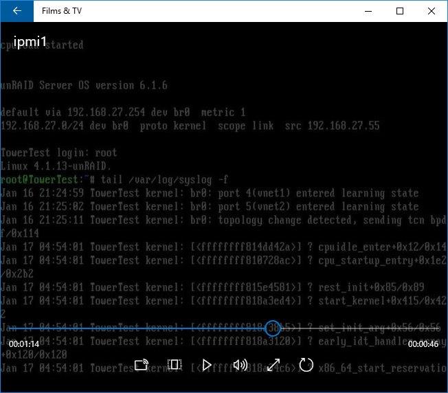

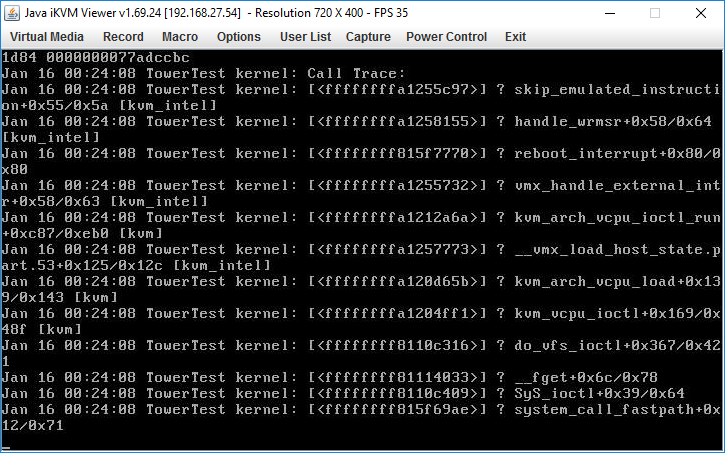

I was running tail on the console and I think I just caught it before the 1st error scrolled off the screen.
2nd screenshot
Tried again, with xhci disabled in the bios.
I managed to capture some more messages by recording the IPMI before rebooting the VM that causes the crash. Here are the screenshots.

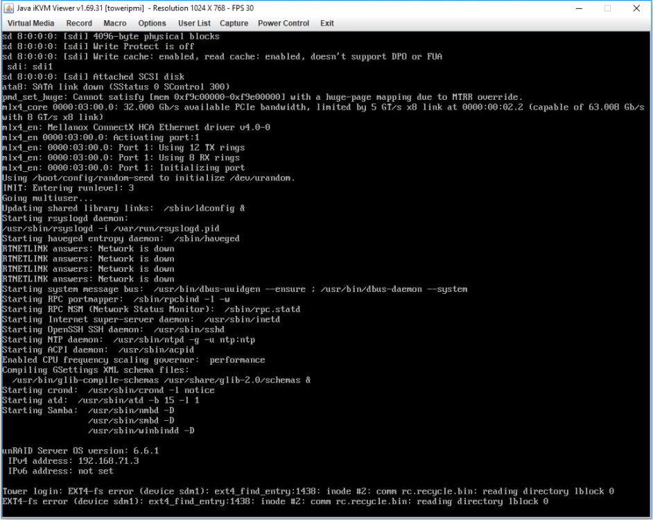

This system has been fine since Feb 2016 on version 6.2. But now it has crashed a 3 times over the last 2 weeks. Crashing started on v6.5.3 and I had another crash after upgrading to 6.6.1 last week.
Same CPU, Memory, PSU, Motherboard. A few additional drives. The PSU is a Seasonic 400W Platinum SS-400FL2.
The case is different - now one of these. https://www.logic-case.com/products/rackmount-chassis/3u/3u-server-case-w-16x-35-hot-swappable-satasas-drive-bays-minisas-atx-psu-sc-316-atx/

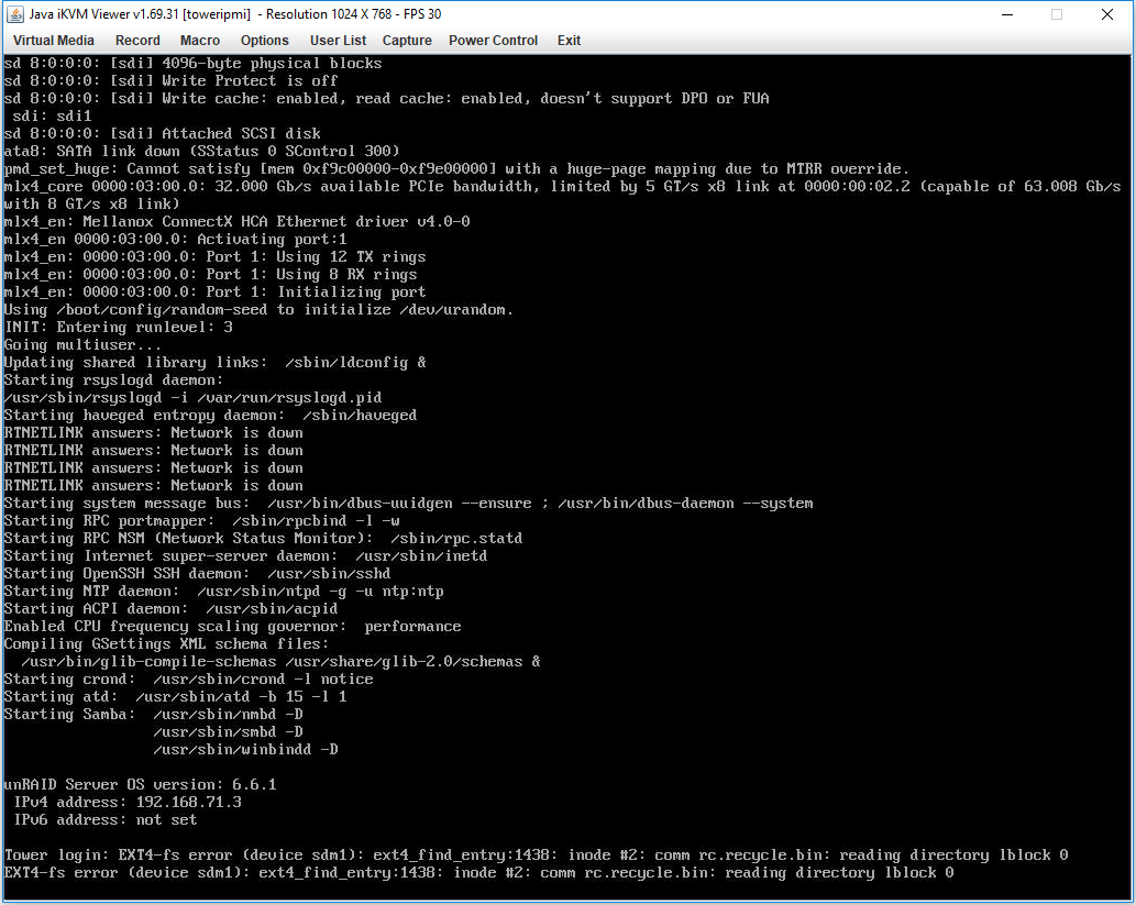

I attach diagnostics from the boot after the crash and a screenshot of the IPMI when it locked up. I don't know if the error shown is related to the lockup or not.
Any suggestions, or should I think about changing the MB and CPU?
Thanks.
tower-diagnostics-20181009-2201.zip
Hi, anyone got any suggestions? Cheers!
Is it stable if you go back to say 6.4.0? You need to find out if something on your hardware went bad or if it is a kernel/microcode issue.
