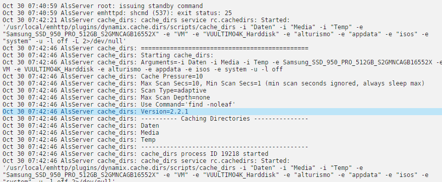

as of update today the script version is 2.2.1, i make a reboot now, thanks for the note.

Ups, forgot attachment as Frank mentioned. Sorry. I havn't read other comments yet.

alturismo: It looks good.
Regarding plugin: 2018.10.14: That's the broken one.
Regarding script version shown on the plugin-page of 'Folder-caching'. This is the version of cache-dirs. I messed up the versioning. The old version in the 2018.10.14 and previous is script version 2.2.0j. I started labeling from 2.2.0a in the above thread in my debugging session with Fireball3 so 2.2.0a - 2.2.0d is NEWER than 2.2.0j. But ignore all that and just go with the new version I linked above on my Fork of dynamix, it should read script version 2.2.1 when installed, just like @alturismo showed.
5 hours ago, Fireball3 said:
Guys, why don't you give it a try?
I followed your instructions and it seems to work now. Thank you and a big thanks to Alex R. Berg.
I also disabled auto update for the Dynamix Cache Dirs plugin for the time being. While it's working now, it still would be great to have an "official" solution to these problems with cache dirs, as I think it's a very essential part of making the unRAID experience enjoyable. So essential that it probably makes sense to fully integrate it into the unRAID code.
