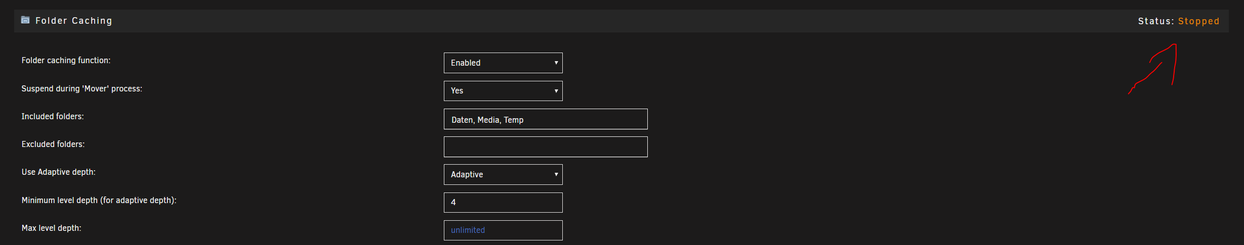

Should the folder caching status indicator accurate in the settings page? It shows me stopped, while in the log I have:
Oct 30 21:50:03 Tower cache_dirs: cache_dirs service rc.cachedirs: Started: '/usr/local/emhttp/plugins/dynamix.cache.dirs/scripts/cache_dirs -i "Movies" -c 2 -p 8 -l on 2>/dev/null'
9 minutes ago, olympia said:
Many thanks Alex for your efforts!

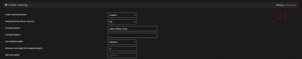

+1 here, i know i had the status "running" before ... and i enabled logs, but there where no logs at /var/log/
i now turned logs off and rebooted server again.

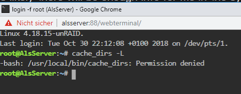

Regarding status stopped after reboot: Send me a unraid diagnostics, and also do a cache_dirs -L, and send me the logs it collects. Before that run it with logs -enabled. Its likely there will be enough info for me in the syslog, so if you are in a hurry just send that. I'm off to bed. I'll look at it in the next couple of days. I did include a change from the broken 2018.10.14 version in the recent two plugins, maybe that is causing the restart issues, but I also added logging so the syslog should inform me.
The indicator worked for Fireball3 when he had issues, so I suspect it does. The cache_dirs -L gives me all that info as to whether its actually running now, and more detailed info.
chmod to 777 changed the status to running ;)
That did the trick.  For anyone else who wants to do this the cache_dirs file is actually in this directory:
The commands using the built-in Terminal popup to make the permission change are :
cd /usr/local/emhttp/plugins/dynamix.cache.dirs/scripts
chmod 777 cache_dirs
EDIT:  IF you reboot your computer you will have to make these changes again as you are making the change to the file in on the RAM disk that Unraid uses to install the OS on.
