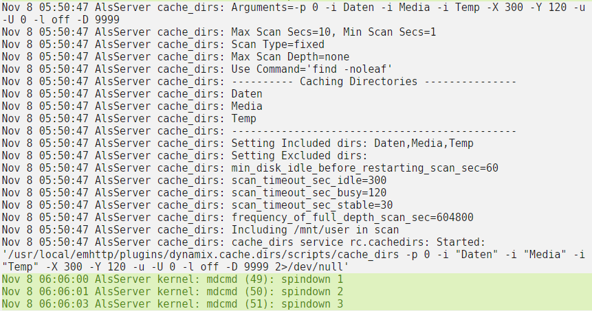

FYI
v2.2.4 started itself properly when the server was rebooted (os update). I still have the message on the console (last line before uR version & IP display):
cat: write error: Broken pipe
With the plugin disabled the drives spin down as per below, but without the cachedir plugin a Plex scan will spin up all the disks that are part of that share.
The plugin did stop that from happening by holding the directories in memory during the scan.
Though disks are spun down without the cachedir its not an ideal situation. :)
In all fairness when i did my plugin upgrade i never rebooted, so i will go do that now.
But my settings for cachedir are below as well, do they look right.1203137414_plugindisabled..JPG.e88eee9c6dd9b866aa1601657b6373a7.JPGcache.thumb.JPG.130392a147025b0dd18e596187c04189.JPG
the reboot was only once required after changing the "broken" script.
since then i didnt had to reboot on changes etc ... i think you can follow this in logs, i started this plugin manually after update to 664 this morning,
when u see all lines (not only the 1 line) you should be good, also here the disks spin down automatically after the timeout (here 15 mins)
they spinned up by activating the plugin and then ... as it should be, perfect ;)
looks to be fixed after a reboot and the plugin changed.

Updated to unRAID 6.6.4 and problem with spinning up disks is no longer present!
But it seems to use alot of CPU, around 10% with plugin disabled. And 30%+ when enabled.
Changed to adaptive, and it's sleeping for 10s insted of only 1 with fixed. And the cpu is much less spiky.
Thanks for your support @Alex R. Berg
Edited by jowe
CPU
For me update plugin and restarting only worked half way. But since i upgraded to 6.6.5 its working perfeclty and disks spinning down again... but didnt saw any changes in log which indicates anything... mysterios.
