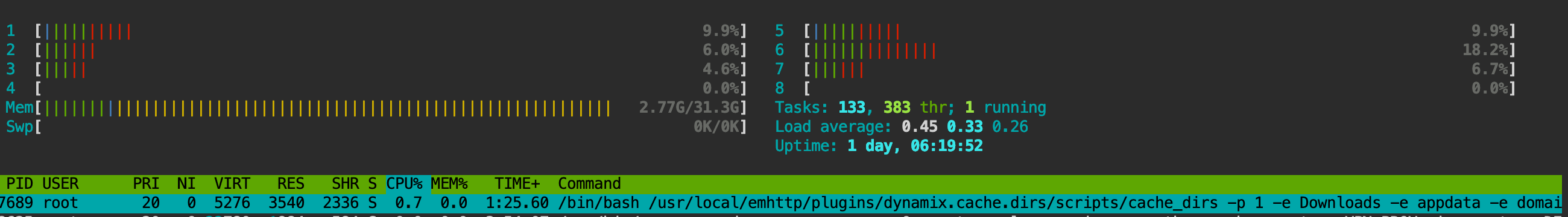

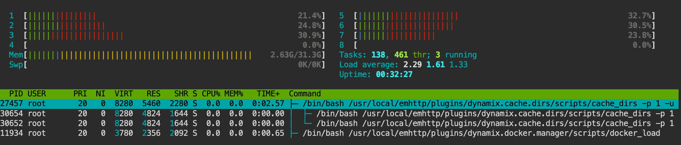

HI everyone,

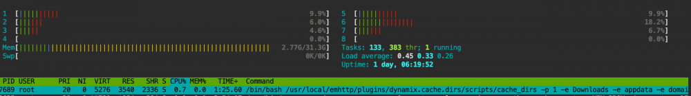

I'm using cache_dirs for a while, and I noticed my disks always spin up when accessing root folders which cache_dirs should avoid. i went to investigate and it seems that it might not be doing anything.
I restarted it, and left it running overnight and got this:
540947424_Screenshot2019-03-29at22_51_53.thumb.png.a6c3b089c8babd474e2ed2f9cfe9df96.png
I checked during the day, and it was the same as now. No memory increase on the process, seems to be stoped all the time, with some sporadic 0,7% cpu spikes. And the uptime seems to indicate the process restarted.
And the cache_dirs process is using the same exact memory as when I started it.....strange. Also the up time indicates that it might have crashed.

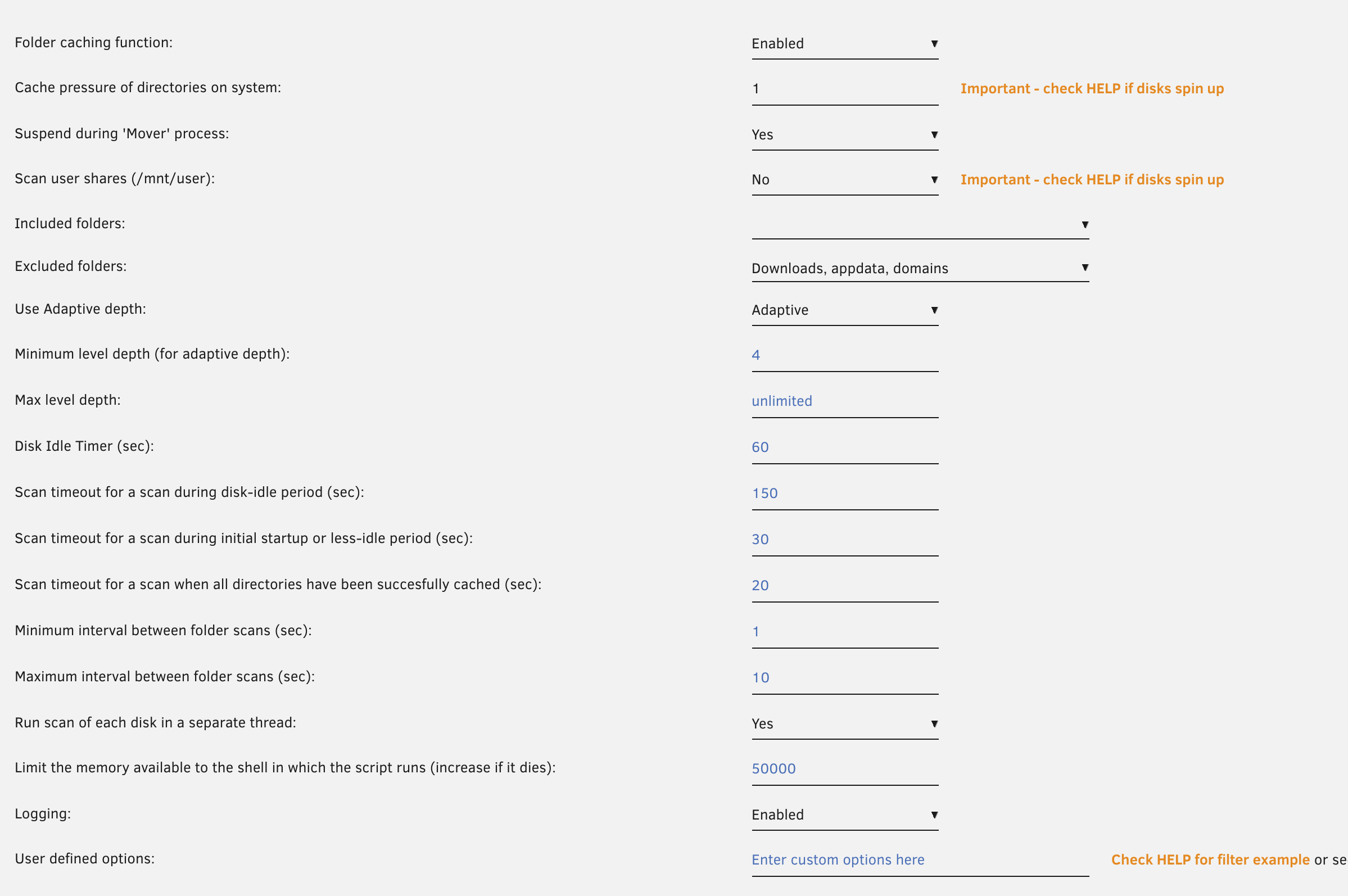

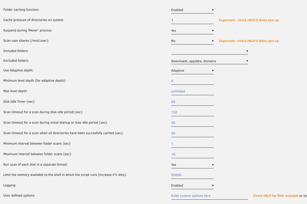

Here are my settings:
1174598965_Screenshot2019-03-29at00_49_38.thumb.png.f64a9da75616ba1e01b3adcd1d0de752.png
Also tried cache pressure as default (10) to with no change on the behaviour.
Also I noticed that no logs where created in the respective folder:
1544242803_Screenshot2019-03-29at00_44_31.thumb.png.b79fa671811992b5e5dea491f0977734.png
My server has 32gb of ram and 16tb of storage. Unraid version 6.7.0-rc6 and the latest version of cache_dirs.
This is all so fishy, am I doing something wrong, I tried default settings, and already tried to exclude some recommended directories with no success.
What to do now?
Thanks.

Also how can I run the script manually? Coding is not something I'm into, sorry.
I also noticed that the command spawns some child commands that last for less than a second and then go away, is this normal, or cache_dirs crashing?
See the moment they appear:
96821242_Screenshot2019-04-01at23_28_21.thumb.png.76395e46d00d729f7656a0044823c765.png
Another thing I tried downgrading unraid to the previous version (6.7.0-rc5) and I still have the same behaviour.
Thanks.
On 4/1/2019 at 11:33 PM, l3gion said:
Can't seem to find the switch to disable background anywhere. Were is it specifically?
Thanks.
I'm sorry I don't have the time to go into a detailed problem solving session. Its probably uphill for you if you are not familiar with scripts, but here's some hints.
cache_dirs should be in path, otherwise use `/usr/local/emhttp/plugins/dynamix.cache.dirs/scripts/cache_dirs`
 sudo /usr/local/emhttp/plugins/dynamix.cache.dirs/scripts/cache_dirs -h
gives you the commands it runs.
It spaws find-subprocesses, which does the actual reading of dirs, so yeah it indicates cache_dirs is not your problem, though of cause maybe it caches to little, when you see those folders. Maybe you have to little ram, but that's just guess-work.
Cache_dirs only caches /mnt/disk* and /mnt/cache, not other root folders, but those root folders should be mounted in memory-space on UnRaid. Unless you've done some manual mounts, which I doubt you have.
Best Alex

VM Performance Issues with cachedirs enabled.  Hi everyone, I'm just looking for a few hints around where to look within the folder caching options to identify what is causing some fairly serious performance issues.  I was suspicious this was actually a networking issue at first but it turns out when I turn off the folder caching plugin my performance issues go away.
I have a 32 thread thread ripper, 128GB RAM, and various HDD / SDD / NVME.  The windows gaming vm on the NVME works flawlessly with this plugin off, but when I turn it on, the screen freezes while playing, sometimes for multiple seconds between 3-5 by which time I've been killed lol.
It's taken a long time to figure this out - because it really wasn't obvious.  I have a CrashPlan backup system that runs permanently in the background which is why I need to have almost all folders available to this plugin - otherwise CrashPlan starts up the disks all the time to check for changed files.  I could of course change this to daily or something - but really that's not a great solution.
See below screenshot for my current settings.  (I'm running Unraid 6.7.0 RC8).
Do I need to increase the shell memory for a large number of files?  I have about 48TB of storage.
Thanks.
76832616_ScreenShot2019-05-11at09_35_15.thumb.png.448ae50809e5eec3519cd3f9dfd55385.png
Wow, nice machine :) Its low-level stuff in linux that does the reading of the directory structure. Cache-dirs itself just calls many find-processes. I think I mentioned in previous messages about how many files I have and what memory I use, so if you skim above you might find something. I cant think of anything helpful for you, except experiment. You can see if cache-dirs is currently scanning disks, check the cache_dirs debug flags, the script contains some statements that might help you debug, if you are not already an expert at linux.
