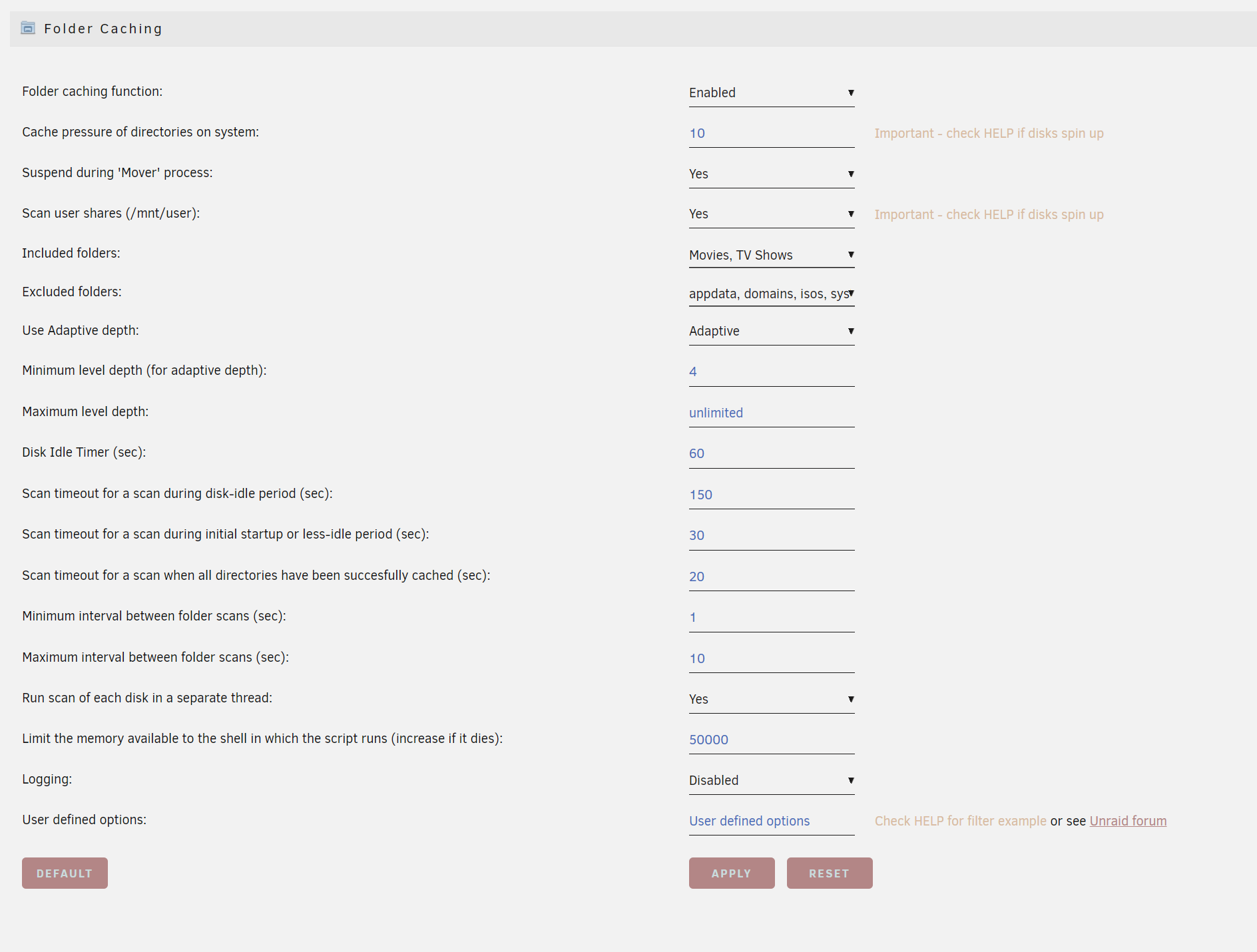

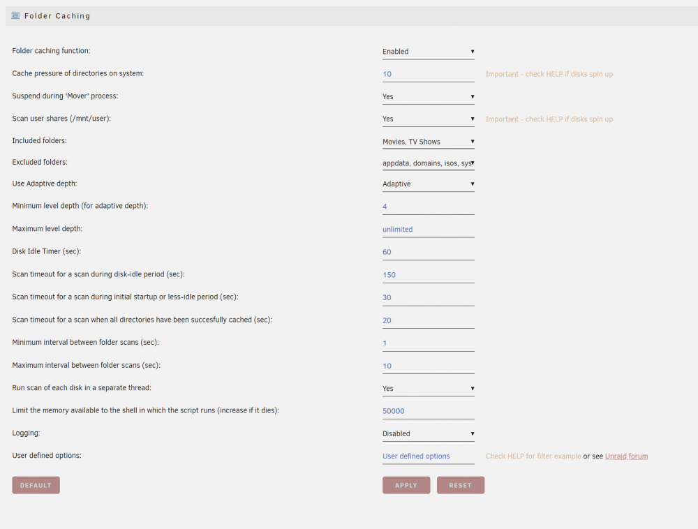

Hi
Does this look correct?
Folder Caching is setup on Movies and TVShows as the primary purpose is a PLEX server.
Excluded are appdatam domains, isos, system, www as these are on my cache drive.
I think I sae this setup from a video, but cant find it and now just the clarify with the pro's.
Thanks
Chris
18 minutes ago, SmokeyColes said:
Hi
Thanks
Chris
Just include the shares you want cache_dirs to handle, all others are then excluded.  No need to specify the excluded shares.
Thank you for your help.

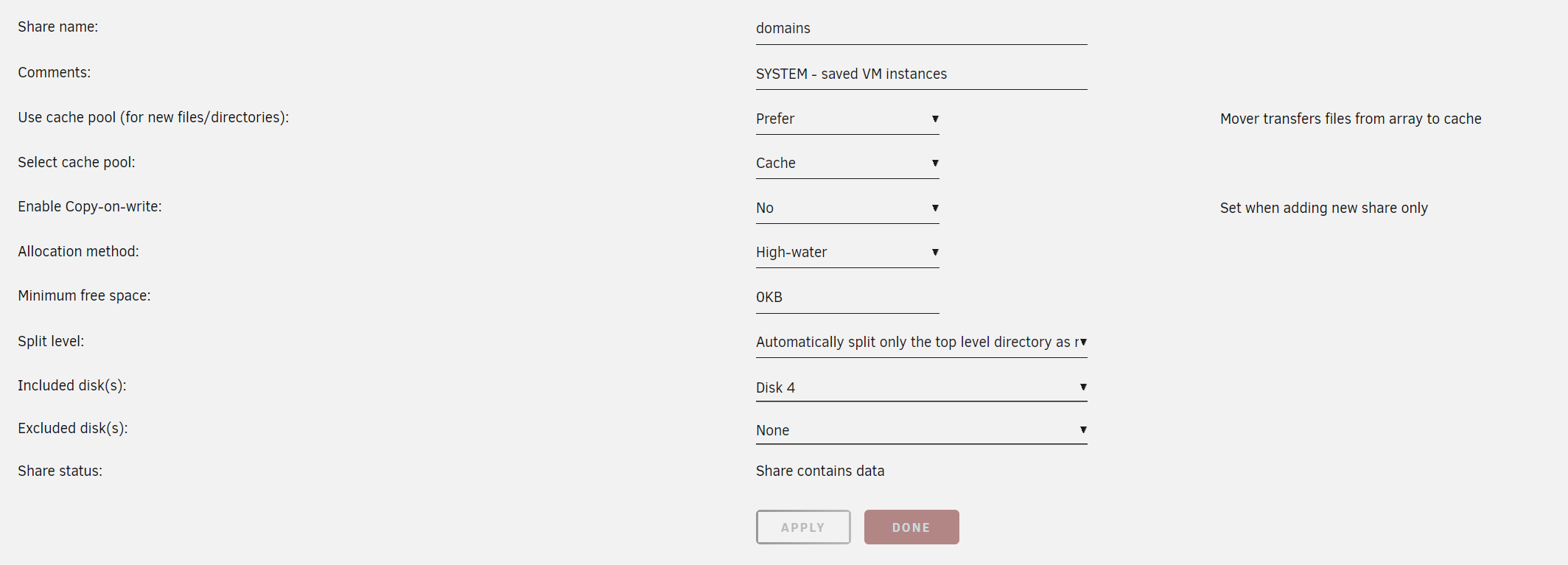

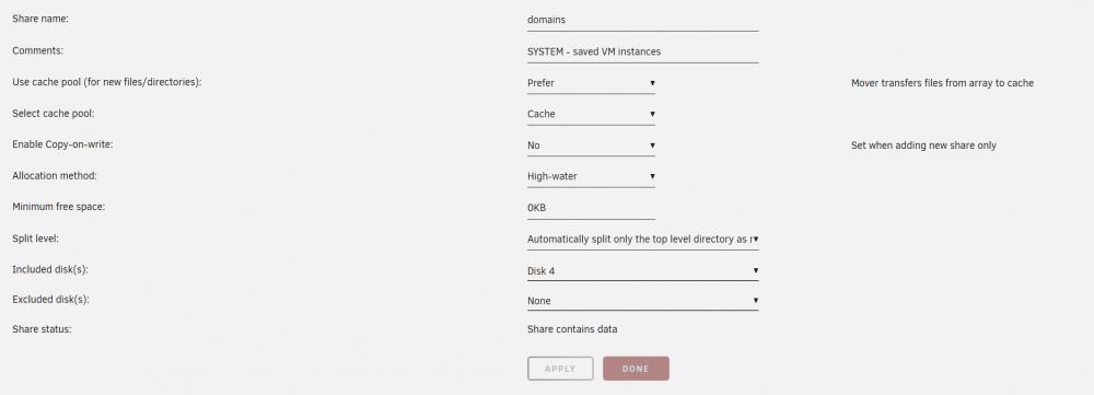

So if my: appdatam domains, isos, system, www
folders are on the cache drive like the following image.
I will remove them from excluded.
Is this meaning that these folders and constantly fast access on the cache drive.
And the TVshows/movies remain on the array but cached for quicker read access?
If your cache is a SSD, cache dirs is not really necessary for cache only shares.  Cache dirs is intended for spinning disks.  The idea is to not spin up a disk when accessing directories - like browsing a share.  This keeps disks from spinning up unnecessarily and you don't have a delay while waiting for a disk to spin up.

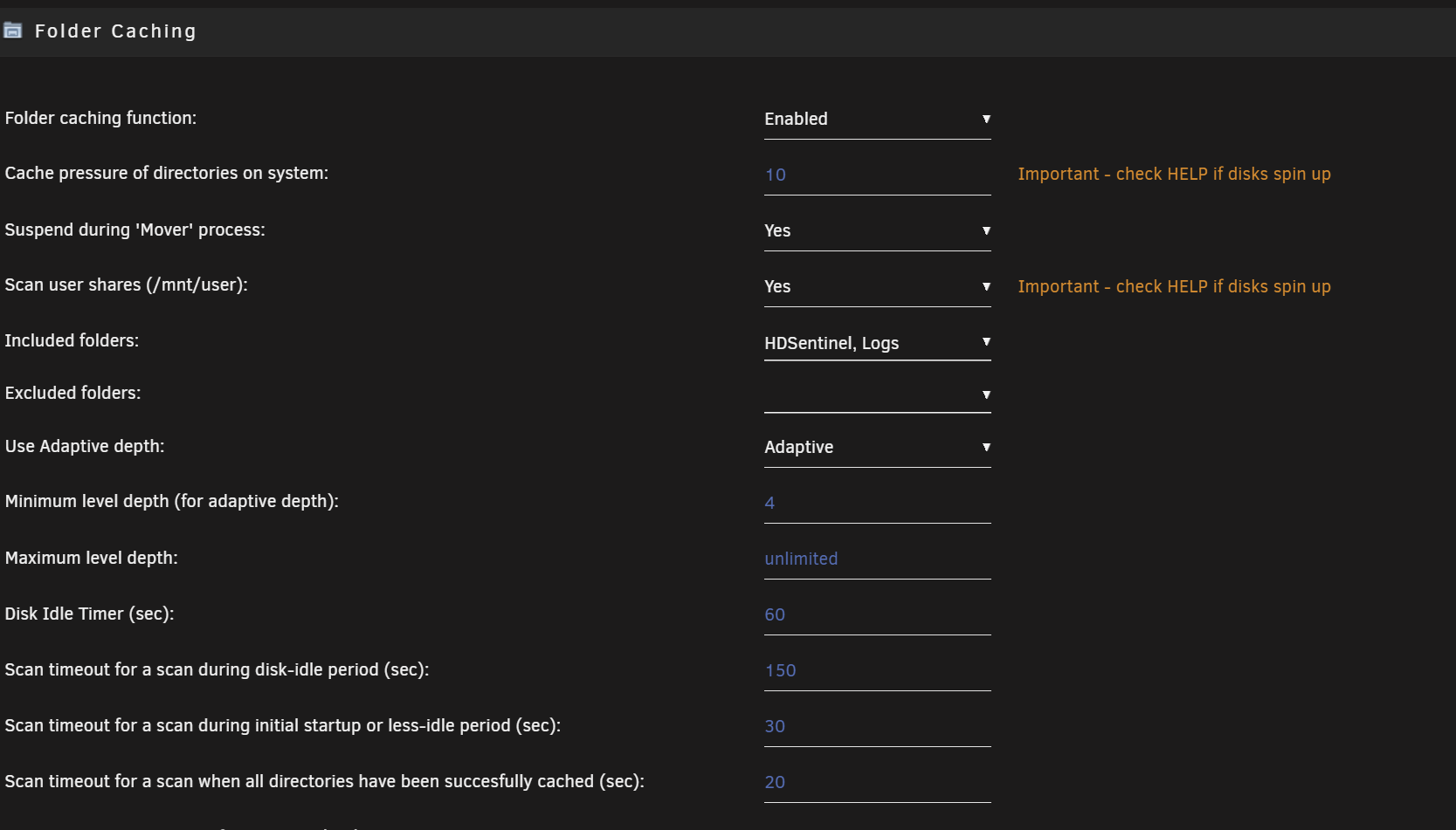

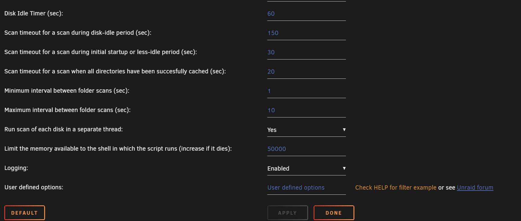

What is right setting for cache dirs for logs ?
if i want not spin up disk and also save ssd resources.
(smart log (HDSentinel),Logs) ,also having 2 cache ssd drives
HDSentinel make *.html -smart log every 10min on ssd (prefer cash)
and Log (syslog) in disk1 ...
Edited by Masterwishx
  • 4 weeks later...
But if i want to use cache dirs for logs that in SSD cache for save SSD wear is it good choice ?
No. SSD reads are "free", they don't add measurable wear. It's only writes that wear out SSD's. There is a reason TBW is specified for SSD's.
Yes , i know i meaned to use cache dirs for save writes wear of SDD .
i thought if cache dirs using directory in RAM we can also write to it.
is cache dirs only used for read only ?
This.
