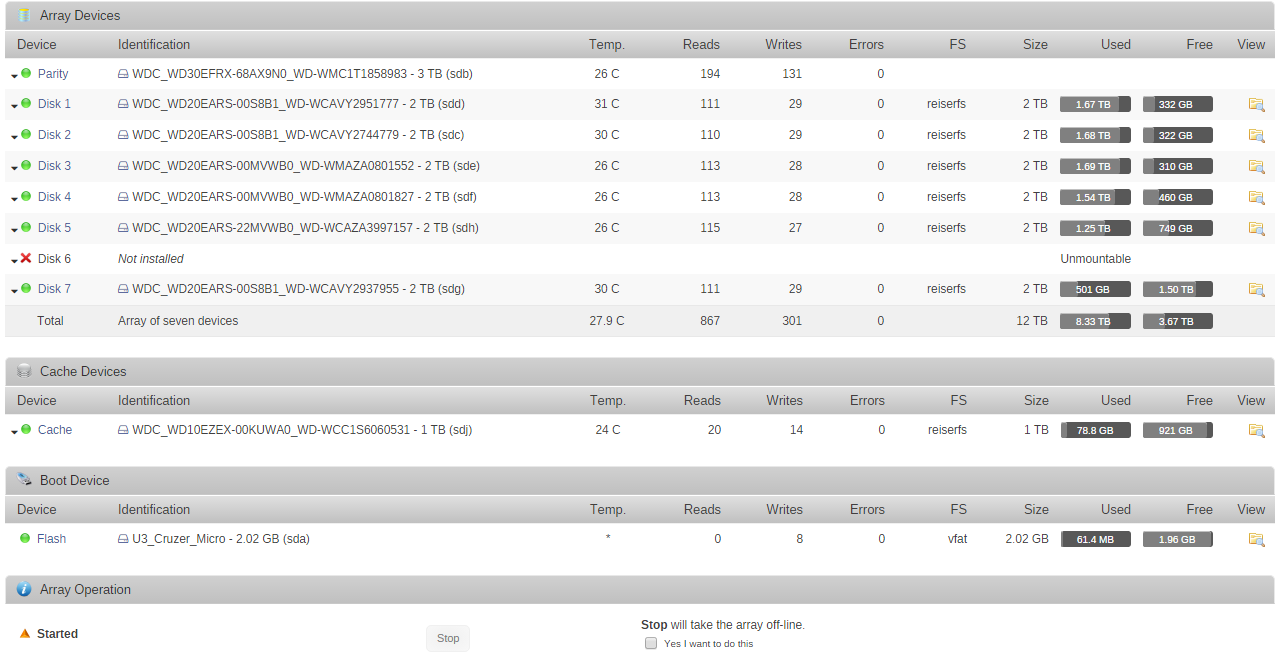

Upgraded from v5, what's wrong with my drive?
I say upgrade, but I really just did a fresh install and chose the same discs as before and started up the array.
Here is my old array: http://i.imgur.com/2Rk8dto.png
This is my new array: http://i.imgur.com/b4Uf3ir.png
How can I tell what's wrong with disk 6? Is there a log I can checkout somewhere? It seemed to be fine before (or maybe not?)

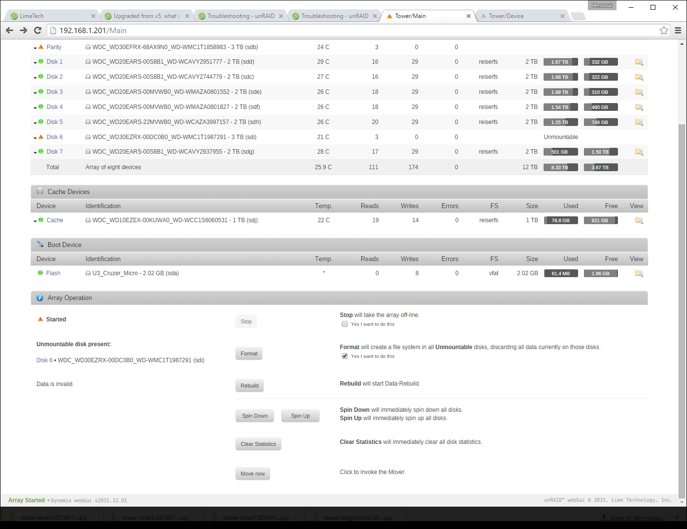

Looking at your screens, your v5 array had disk6 disable, did you upgrade to v6 like that?
How did you upgraded? By doing a new config?
Because on your v6 screen you have parity building and also disk6 disable, so if you did a new config and tried do sync parity before replacing disk6 you could have invalidate your parity.
Yes, someone had to actually point out to me that the orb wasn't green in my screenshot. Being severely colour blind, it may have been red (I think?) for some time now. The one thing I had noticed recently was that none of my drives were ever spinning down, they all seemed to be active all the time. Would this be a symptom of reading from parity because of an offline drive?

So it does show the disk as emulated, but it's also showing no disk content when I try to browse it. Hmmm.
That what I was afraid off, parity was damaged on latest sync, is it unmountable like earlier v6 screenshot?

Yeah it's still unmountable. However the red X is gone and I've just got that warning icon on it now. It gives me the option to rebuild, would it be worth trying that at this point?
Attached is the current state of the array through the UI.
Parity should be green, did you check the trust parity option?
You have to do a new config and before starting array check the option to trust parity, right next to the start button.
Then stop the array, unassign disk6 and start array again, every disk has to be green except disk6.

Thanks I installed from scratch again, and parity is happy now. Disk 6 is back to an X, though. I'm starting to think it was a legit disk failure.
EDIT: Just to be clear the red X was there even when it was still assigned to the array.
