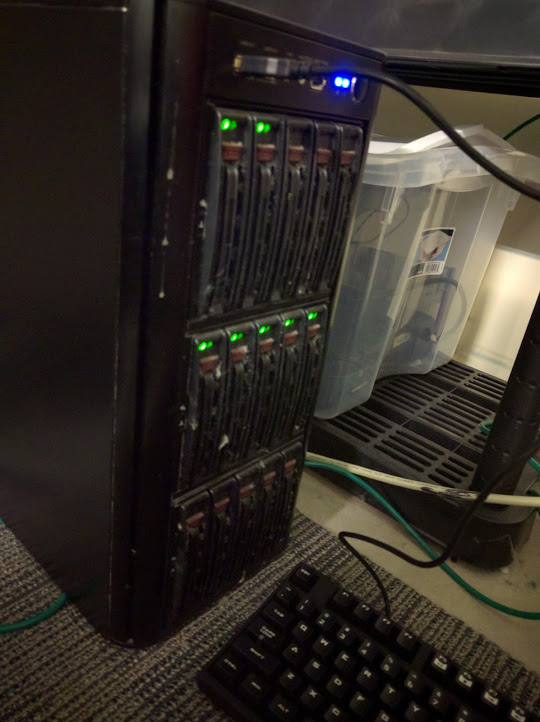

I noticed however, that every drive LED except disk6's (and cache) is lit up right now. I think the disk6 may have disappeared completely. If that's the case, what will this accomplish?
Attaching server hard at work (disk6 is bottom left, not lit up). And yes it's very very dusty. Shameful :(
This is normal, you are trying to fix the emulated disk6, it’s emulated by all other disks + parity, actual disk6 is currently not in use.

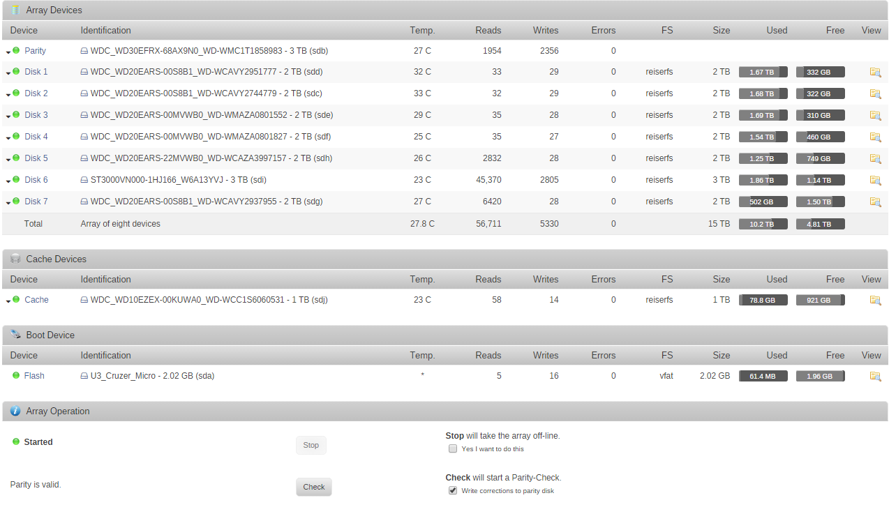

This is exactly what I did and the data loss on disk 6 was pretty minimal.
I used a 3TB Seagate NAS drive and I'm hoping it lasts longer than that 3TB WD green!
Attached happy looking screenshot :)
