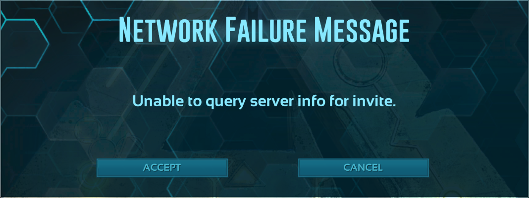

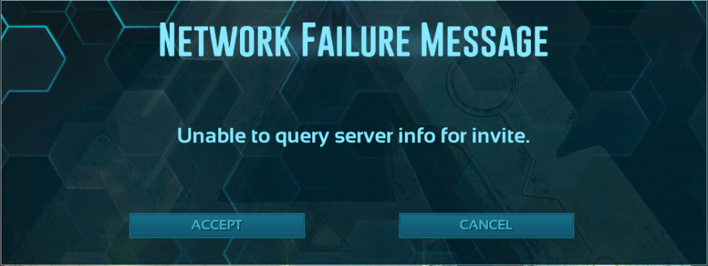

January 22, 20188 yr @csmccarron followed everything and was able to find the server. Its only under the LAN tab, does this mean that the forwarding isn't working and my friends cant find the server? but when i connect to it i get the following message. my game is also v276.42 Edited January 22, 20188 yr by ToXIc
March 8, 20188 yr On 1/22/2018 at 12:08 AM, ToXIc said: @csmccarron followed everything and was able to find the server. Its only under the LAN tab, does this mean that the forwarding isn't working and my friends cant find the server? but when i connect to it i get the following message. my game is also v276.42 I would check the forwarding on your router.
