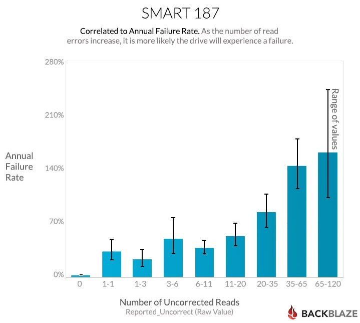

Reported uncorrected is one the bad ones, I would replace it asap.
