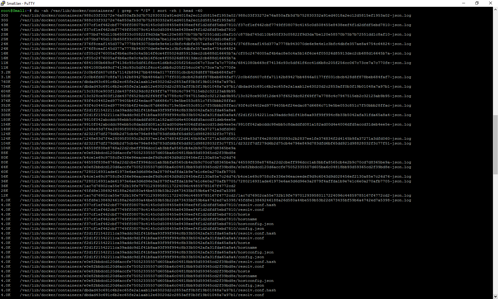

PS. If anyone's interested in checking how big their logs are, type this in the unraid terminal and it will list the largest logs:
du -ah /var/lib/docker/containers/ | grep -v "/$" | sort -rh | head -60

Telnet/SSH to unRAID.  Issue the command in Aptalca's post:
It lists the logs for the containers and their sizes.  Locate the Docker Container ID in the list of a desired (large) log to delete:
Go to the unRAID GUI Docker tab.  Turn on advanced view.  Find the container that matches the ID from the 'du' command.
To delete the log, issue the command below with the name of the container (case sensitive)
echo "" > $(docker inspect --format='{{.LogPath}}' sabnzbd)
