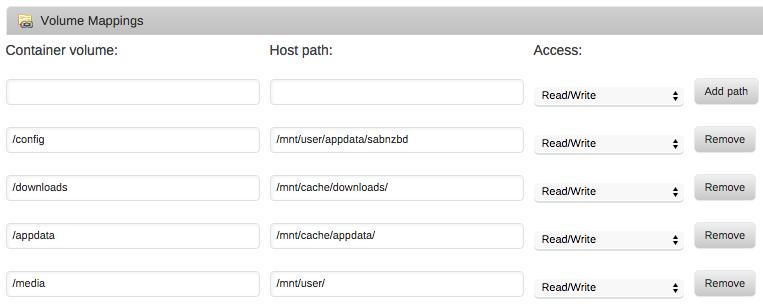

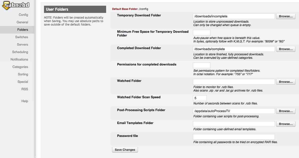

Thanks danioj, I have had the default "watched folder" method setup and guess automatically just wanted to have feature parity from SickBeard. Will take your advice and see how this goes. Thanks again!
1) Download nzbtomedia and expand it to your docker apps location
2) In docker settings of sabnzbd, add a volume mapping to the nzbtomedia folder from step 1
3) In sabnzbd folder settings, set post-processing scripts folder to the folder that you set in step 2

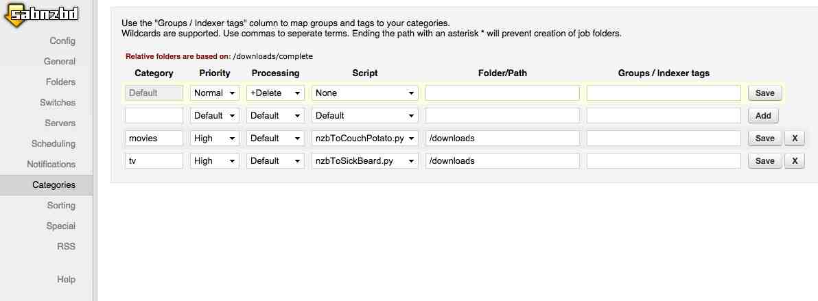

3a) In sabnzbd category settings make sure a category exists for couchpotato to use and select the nzbtocouchpotato.py script
3b) do the same for sickrage and select the nzbtosickbeard.py script

Thanks so much for the write-up, spencers! I followed along, but for whatever reason, can't get Sabnzbd to change my folder to the nzbtomedia folder I downloaded/extracted (step 3). It won't stick for some reason (tried a new folder that I created a volume mapping for, tried putting it in the existing scripts folder that's currently being used but to no avail). Any thoughts?
copied/pasted the contents of the nzbtomedia folder into my current (autoprocesstv) folder and was able to access the script. However, this is the error I get when trying to post process:

The script is in /mnt/cache/appdata/autoprocessTV because it's the only folder that I can use it seems with Sabnzbd.. I basically had to copy/paste the contents of the nzbtomedia folder into this folder in order to select the proper script within Sabnzbd. Attaching Sabnzbd config screenshots for reference.

Post me a screenshot of you sabnzbd mappings...
Attached. Thanks so much btw for your help with this!

Location for nzbToMedia folder
/mnt/cache/.appdata/sabnzbd/nzbToMedia
SABNzbd folders
End result
[00:30:33] [postPROCESS]::SICKBEARD: Successfully processed
Note, my appdata folder has a period in front of it, so watch out for that.  I also believe this is the neatest way to get it all setup...
Then selected it in the webui like so...

Thanks! That was it, the category was movie in the script and "movies" in Sab and Couch.
