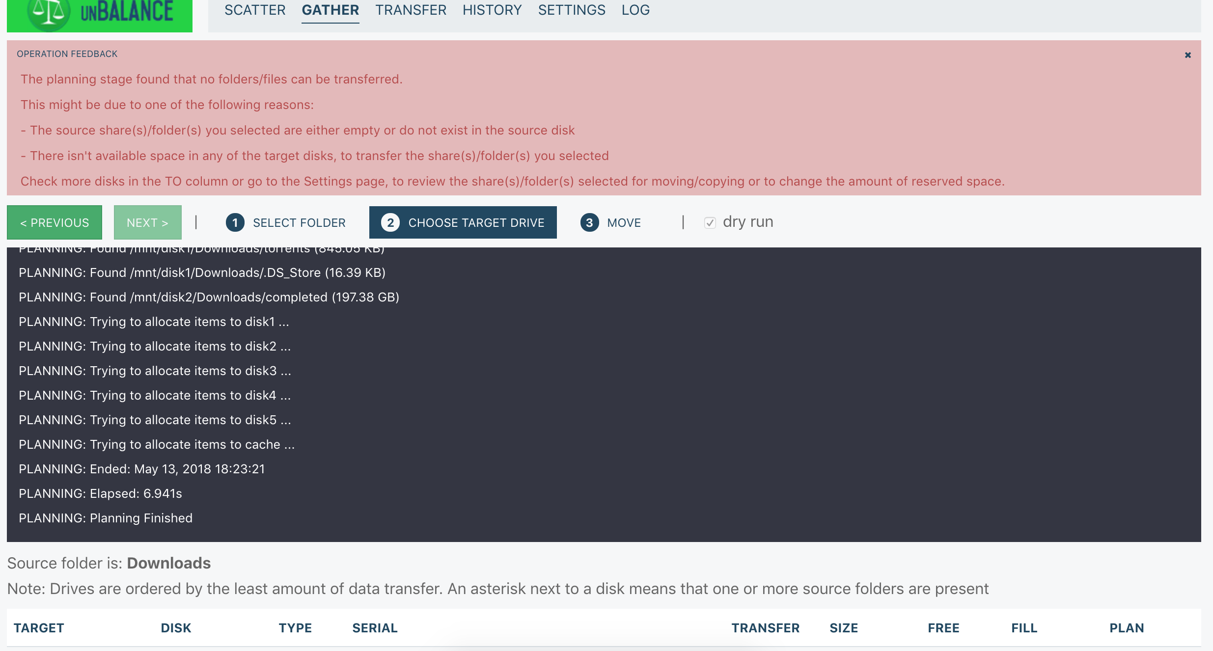

ivanf Posted May 13, 2018 Share Posted May 13, 2018 Hi all so the problem I have been having out of no where is #1 I can't access the webUI without using https for some reason. I have never touched any settings relating to the best of my knowledge. #2 issue is I followed the space invader vids.. but I am unable to select any disk at all. Here is the error I am seeing. Quote Link to comment
jbrodriguez Posted May 14, 2018 Author Share Posted May 14, 2018 Hi ivanf, can you send me /boot/logs/unbalance.log to check it out ? (pm if you prefer) As for https, if your unRAID's SSL is set to 'yes' or 'auto', the plugin will listen on https. Quote Link to comment
ivanf Posted May 14, 2018 Share Posted May 14, 2018 3 hours ago, jbrodriguez said: Hi ivanf, can you send me /boot/logs/unbalance.log to check it out ? (pm if you prefer) As for https, if your unRAID's SSL is set to 'yes' or 'auto', the plugin will listen on https. Extremely sorry for the trouble. How would I be able to access this? I'm new to linux and unraid. Quote Link to comment
jbrodriguez Posted May 14, 2018 Author Share Posted May 14, 2018 If you have your unRAID server as a network map in Windows or a Mac, it would be the flash share, so flash/logs/unbalance.log. You could also scp from a mac or windows (putty). Quote Link to comment

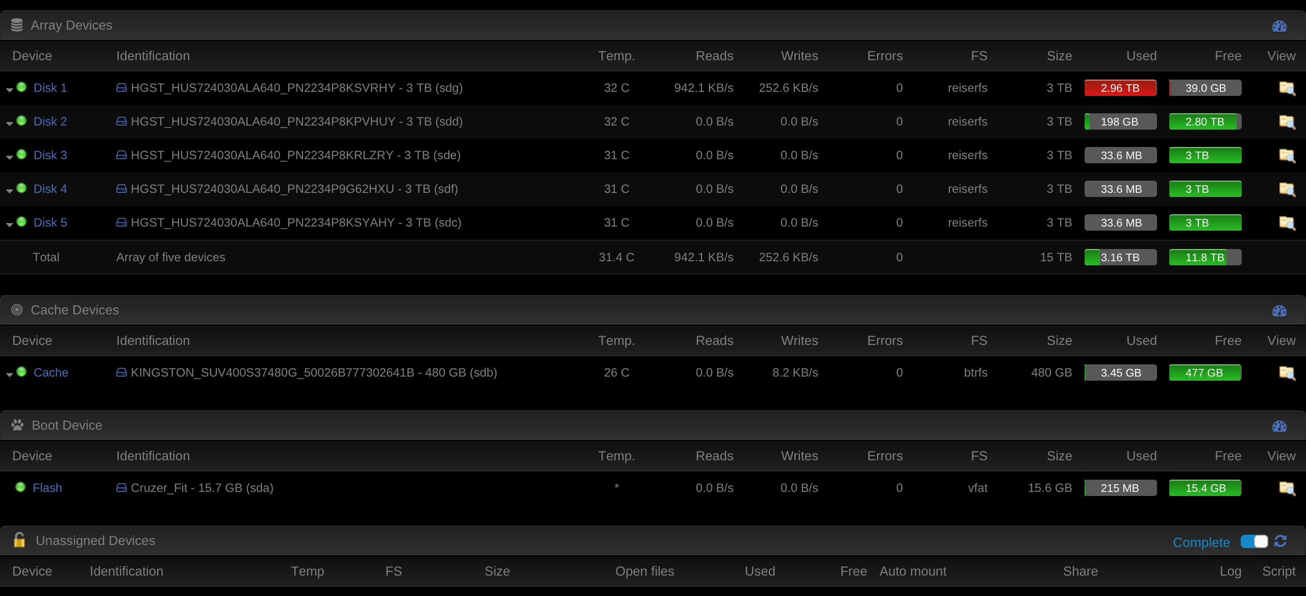

jbrodriguez Posted May 15, 2018 Author Share Posted May 15, 2018 ivanf, these are the relevant log lines I: 2018/05/14 21:43:49 planner.go:157: Running gather planner ... I: 2018/05/14 21:43:49 planner.go:352: scanning:disk(/mnt/disk1):folder(Downloads) I: 2018/05/14 21:43:56 planner.go:381: items:count(6):size(2.95 TB) I: 2018/05/14 21:43:56 planner.go:352: scanning:disk(/mnt/disk2):folder(Downloads) I: 2018/05/14 21:43:56 planner.go:381: items:count(1):size(219.05 GB) I: 2018/05/14 21:43:56 planner.go:352: scanning:disk(/mnt/cache):folder(Downloads) I: 2018/05/14 21:43:56 planner.go:381: items:count(2):size(5.02 GB) I: 2018/05/14 21:43:56 planner.go:505: disk(/mnt/disk1):fs(reiserfs):no-items:currentFree(39.05 GB) I: 2018/05/14 21:43:56 planner.go:505: disk(/mnt/disk2):fs(reiserfs):no-items:currentFree(2.78 TB) I: 2018/05/14 21:43:56 planner.go:505: disk(/mnt/disk3):fs(reiserfs):no-items:currentFree(3.00 TB) I: 2018/05/14 21:43:56 planner.go:505: disk(/mnt/disk4):fs(reiserfs):no-items:currentFree(3.00 TB) I: 2018/05/14 21:43:56 planner.go:505: disk(/mnt/disk5):fs(reiserfs):no-items:currentFree(3.00 TB) I: 2018/05/14 21:43:56 planner.go:505: disk(/mnt/cache):fs(btrfs):no-items:currentFree(470.91 GB) You're trying to gather the Downloads share into a single disk, but there's not enough space in any of your disks to do so. A consolidated Downloads folder would be approx 3.17Tb (2.95Tb + 219Gb + 5Gb) Your largest disk is 3Tb, so it can't fit the whole Downloads share into a single disk. Quote Link to comment
ivanf Posted May 15, 2018 Share Posted May 15, 2018 (edited) 2 hours ago, jbrodriguez said: ivanf, these are the relevant log lines I: 2018/05/14 21:43:49 planner.go:157: Running gather planner ... I: 2018/05/14 21:43:49 planner.go:352: scanning:disk(/mnt/disk1):folder(Downloads) I: 2018/05/14 21:43:56 planner.go:381: items:count(6):size(2.95 TB) I: 2018/05/14 21:43:56 planner.go:352: scanning:disk(/mnt/disk2):folder(Downloads) I: 2018/05/14 21:43:56 planner.go:381: items:count(1):size(219.05 GB) I: 2018/05/14 21:43:56 planner.go:352: scanning:disk(/mnt/cache):folder(Downloads) I: 2018/05/14 21:43:56 planner.go:381: items:count(2):size(5.02 GB) I: 2018/05/14 21:43:56 planner.go:505: disk(/mnt/disk1):fs(reiserfs):no-items:currentFree(39.05 GB) I: 2018/05/14 21:43:56 planner.go:505: disk(/mnt/disk2):fs(reiserfs):no-items:currentFree(2.78 TB) I: 2018/05/14 21:43:56 planner.go:505: disk(/mnt/disk3):fs(reiserfs):no-items:currentFree(3.00 TB) I: 2018/05/14 21:43:56 planner.go:505: disk(/mnt/disk4):fs(reiserfs):no-items:currentFree(3.00 TB) I: 2018/05/14 21:43:56 planner.go:505: disk(/mnt/disk5):fs(reiserfs):no-items:currentFree(3.00 TB) I: 2018/05/14 21:43:56 planner.go:505: disk(/mnt/cache):fs(btrfs):no-items:currentFree(470.91 GB) You're trying to gather the Downloads share into a single disk, but there's not enough space in any of your disks to do so. A consolidated Downloads folder would be approx 3.17Tb (2.95Tb + 219Gb + 5Gb) Your largest disk is 3Tb, so it can't fit the whole Downloads share into a single disk. Yes only disk 1 and part of another disk is also being used. I made a mistake by having my shares go from highwater to Phil. What I want to do now is actually have them go back to what it was before. Edited May 15, 2018 by ivanf Quote Link to comment
ivanf Posted May 16, 2018 Share Posted May 16, 2018 On 5/15/2018 at 6:00 AM, jbrodriguez said: ivanf, these are the relevant log lines I: 2018/05/14 21:43:49 planner.go:157: Running gather planner ... I: 2018/05/14 21:43:49 planner.go:352: scanning:disk(/mnt/disk1):folder(Downloads) I: 2018/05/14 21:43:56 planner.go:381: items:count(6):size(2.95 TB) I: 2018/05/14 21:43:56 planner.go:352: scanning:disk(/mnt/disk2):folder(Downloads) I: 2018/05/14 21:43:56 planner.go:381: items:count(1):size(219.05 GB) I: 2018/05/14 21:43:56 planner.go:352: scanning:disk(/mnt/cache):folder(Downloads) I: 2018/05/14 21:43:56 planner.go:381: items:count(2):size(5.02 GB) I: 2018/05/14 21:43:56 planner.go:505: disk(/mnt/disk1):fs(reiserfs):no-items:currentFree(39.05 GB) I: 2018/05/14 21:43:56 planner.go:505: disk(/mnt/disk2):fs(reiserfs):no-items:currentFree(2.78 TB) I: 2018/05/14 21:43:56 planner.go:505: disk(/mnt/disk3):fs(reiserfs):no-items:currentFree(3.00 TB) I: 2018/05/14 21:43:56 planner.go:505: disk(/mnt/disk4):fs(reiserfs):no-items:currentFree(3.00 TB) I: 2018/05/14 21:43:56 planner.go:505: disk(/mnt/disk5):fs(reiserfs):no-items:currentFree(3.00 TB) I: 2018/05/14 21:43:56 planner.go:505: disk(/mnt/cache):fs(btrfs):no-items:currentFree(470.91 GB) You're trying to gather the Downloads share into a single disk, but there's not enough space in any of your disks to do so. A consolidated Downloads folder would be approx 3.17Tb (2.95Tb + 219Gb + 5Gb) Your largest disk is 3Tb, so it can't fit the whole Downloads share into a single disk. What I want to know is it it possible to have the default highwater do 50% for all disk so my 1st 3tb disk does not get full? I wanted to restore everything to its default. Quote Link to comment
trurl Posted May 17, 2018 Share Posted May 17, 2018 9 hours ago, ivanf said: What I want to know is it it possible to have the default highwater do 50% for all disk so my 1st 3tb disk does not get full? I wanted to restore everything to its default. Not sure if this is what you mean or not, but changing a user share setting only affects where new writes go. Nothing is done to existing files. Quote Link to comment
ivanf Posted May 18, 2018 Share Posted May 18, 2018 On 5/17/2018 at 2:42 AM, trurl said: Not sure if this is what you mean or not, but changing a user share setting only affects where new writes go. Nothing is done to existing files. Oh I see. Is there a way I can change or do new writes for the existing files? Quote Link to comment
trurl Posted May 18, 2018 Share Posted May 18, 2018 3 hours ago, ivanf said: Oh I see. Is there a way I can change or do new writes for the existing files? I think the purpose of the "Scatter" function of this plugin is to redistribute the files from a disk to others. I haven't used this plugin since that was added. Have you tried it? Quote Link to comment
ivanf Posted May 20, 2018 Share Posted May 20, 2018 On 5/18/2018 at 2:01 PM, trurl said: I think the purpose of the "Scatter" function of this plugin is to redistribute the files from a disk to others. I haven't used this plugin since that was added. Have you tried it? Thank you! I think thats what I was looking for Quote Link to comment
