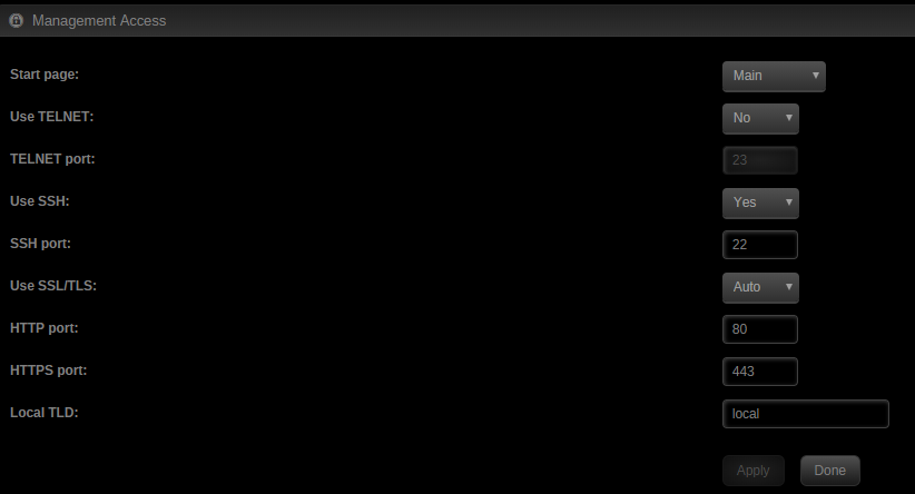

I believe ssl = auto is the default setting in 6.5.x.
Internally it redirects from http to https, so even if you connect to unRAID's webgui via http, you'll be redirected to https.
unBALANCE interprets ssl = auto (and the presence of an ssl certificate) as https, so it only listens on https.
The open web ui link in the plugin settings reflects that.
Now, if you have a bookmark or type directly the address for unBALANCE, over http, in these scenarios, you'll get an error.
I guess I could redirect http-to-https.
Running 6.5.2 on my system. Use SSL is set to auto, but when I access my server it's not redirected to an HTTPS connection.
I guess as a result(?), the "Open Web UI" link in UnBALANCE is left as a regular http:// link.
