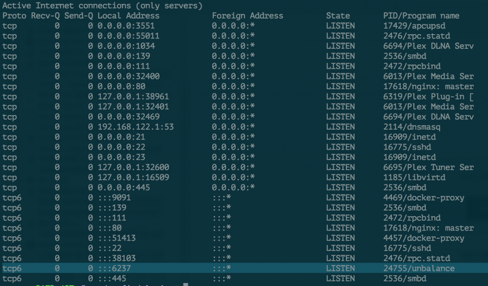

I've just installed unbalance plugin, but it only binds to IPv6 port 6237, is there an option to make it bind to IPv4 as well ?
Thank you.

Hi georgez,
So far, I haven't found a way to bind to both and I'm guessing it prefers ipv6 to ipv4.
I think I found a solution so that it binds to ipv4, but it requires a fix from a third-party library, so ETA for resolution is unknown.
I'm curious ... does it not work at all with ipv6 ?
To be honest, I have no idea how to setup my Mac and router to work with IPv6, hence it never worked for me. The link 'Open Web UI' points to an IPv4 URL http://10.0.1.21:6237, but it's listening on and IPv6 port, this is weird.
George
I'll do some checks on my test system, maybe ipv6 has been selected as priority ?
I'll take a look.
