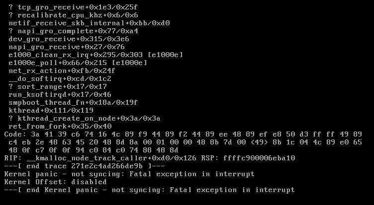

Not sure if anyone can help, but I just updated to the latest build. (I believe I was on the build 5.1.0). I was able to transfer 4TB from one drive to another on 3 days ago, but after the update, transferring no longer seems to be happening. I select one drive in the 'FROM' column and one drive in the 'TO' column and then select all the folders. I go to the next stage and the page loads with all the stats, but transferring does not seem to be happening. It has no 'end-time'. Last time I did this I immediately saw '28 hours' to go. Now when I try to go to the UnRAID main page or the UnBalance page ("https://10.10.10.201:6237" or "https://10.10.10.201") I get "The connection has timed out". This has happened twice already. This last time was after a server reboot.
Edited by micokeman
Additional error information.
Hi, I'm not good at kernel dumps, but does look like some issue with your network card (since the e1000 driver is listed) ?
In any case, the connection timeout indicates the browser (your client) can't reach the server.
Have you tried the console directly ?
