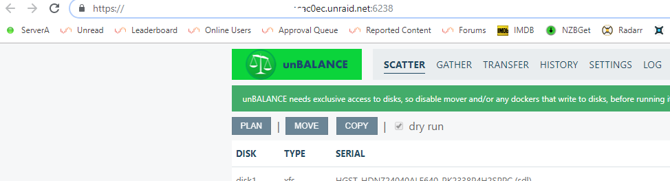

So, it only works via HTTP, but the link on the Unbalance settings page goes to HTTPS and you get an error.
buzz
Works for me
14 minutes ago, Squid said:
Works for me
That's wierd.  I get connection failed in both Chrome and Firefox with HTTPS. Something strange about my setup I'll have to figure out.
Thanks
buzz
Thanks
buzz
I'm noticing the same thing. I'm starting to wonder if this is due to when I setup Let's Encrypt. The plugin seems to have an expired cert and I can't seem to update it.
