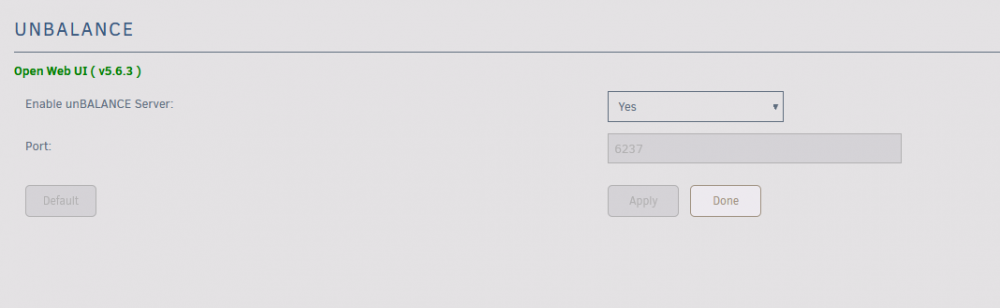

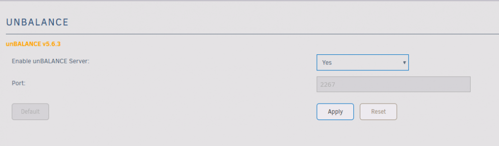

Every time I try to change the port it changes back to the default. What gives?
Hi, not sure what you mean by that.
Can you elaborate ?
Can you elaborate ?
I'm attempting to change to a port that I don't already have forwarded, so the world can't mess with my server.
Although after hitting apply, it defaults to the port below
Is there a way to send data from my current drives in my array (22 disks) to my 1 new drive?  I would like to pull some data off the current ones I have are almost full and I keep getting warnings saying they're filling up.
Adding a new 14tb now so it would be nice to syphon the data from my array into it.  I don't see a way to select multiple sources though in unbalance.
Oh I see, let me take a look at that code on my environment
