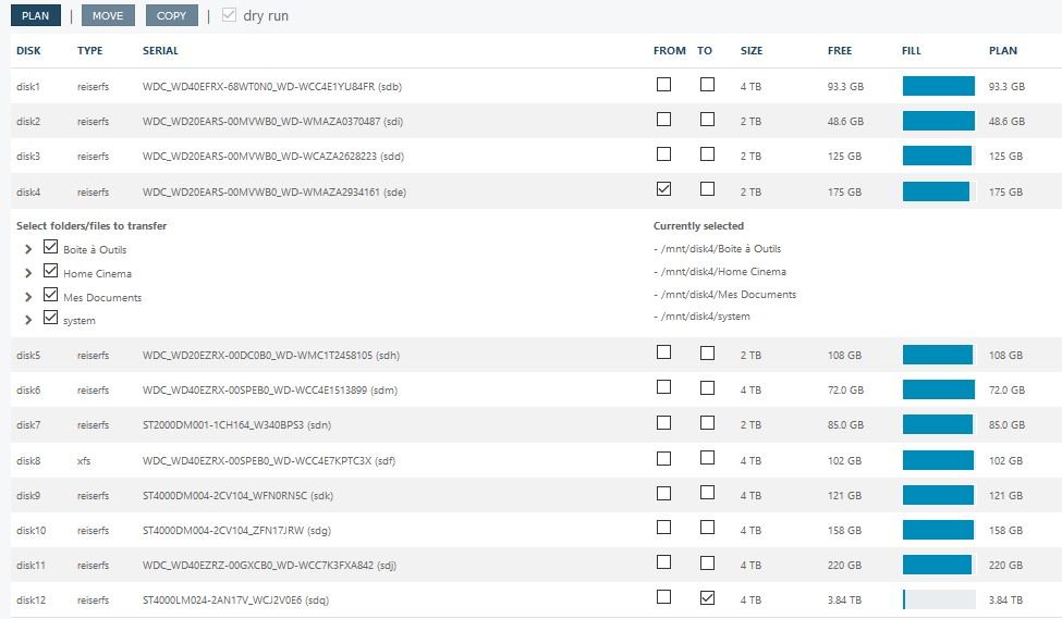

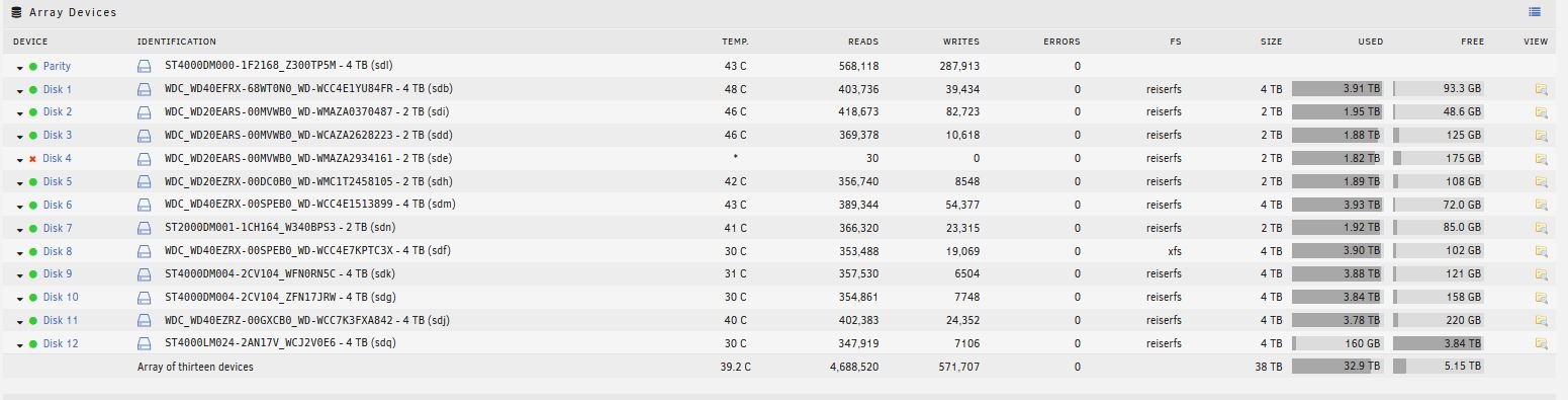

Hello,
My disk4 has been disabled (2 To), but content is still emulated thanks to parity.
I added a fresh new disk into the array (4 To) called disk12.
I plan to move all datas from disk4 (emulated content) to disk12, but nothing is transferred.
Let me show you the logs :

I: 2020/09/01 21:33:51 planner.go:502: [1.26 TB] /mnt/disk4/Home Cinema/./-=[ BluRay Disc ]=-
I: 2020/09/01 21:33:51 planner.go:502: [184.78 GB] /mnt/disk4/Home Cinema/./-=[ HD ]=-
I: 2020/09/01 21:33:51 planner.go:502: [162.79 GB] /mnt/disk4/Home Cinema/./-=[ 4K ]=-
I: 2020/09/01 21:33:51 planner.go:502: [66.57 GB] /mnt/disk4/Home Cinema/./-=[ Download ]=-
I: 2020/09/01 21:33:51 planner.go:502: [52.46 GB] /mnt/disk4/Home Cinema/./-=[ Documentaires ]=-
I: 2020/09/01 21:33:51 planner.go:502: [43.78 GB] /mnt/disk4/Home Cinema/./-=[ 3D ]=-
I: 2020/09/01 21:33:51 planner.go:502: [27.95 GB] /mnt/disk4/Home Cinema/./-=[ Series TV ]=-
I: 2020/09/01 21:33:51 planner.go:502: [21.78 GB] /mnt/disk4/Home Cinema/./-=[ Animation ]=-
I: 2020/09/01 21:33:51 planner.go:502: [949.12 MB] /mnt/disk4/Boite à Outils/./-=[ AppZ ]=-
I: 2020/09/01 21:33:51 planner.go:502: [6.50 MB] /mnt/disk4/Home Cinema/./-=[ DVD ]=-
I: 2020/09/01 21:33:51 planner.go:502: [49.36 KB] /mnt/disk4/Mes Documents/./Nicolas
I: 2020/09/01 21:33:51 planner.go:502: [344.00 B] /mnt/disk4/system/./docker

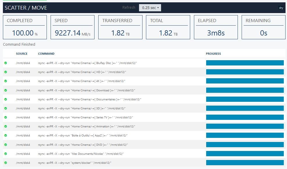

I: 2020/09/01 21:34:02 core.go:687: Running Move operation ...
I: 2020/09/01 21:34:02 core.go:710: Command Started: (src: /mnt/disk4) rsync -avPR -X --dry-run "Home Cinema/-=[ BluRay Disc ]=-" "/mnt/disk12/"
I: 2020/09/01 21:34:02 core.go:185: Sending operation
I: 2020/09/01 21:34:02 core.go:835: monitor:transfer:(/mnt/disk4/Home Cinema/-=[ BluRay Disc ]=-/Chronique de Narnia - Le Lion, la Sorcière blanche et l'Armoire magique,)
I: 2020/09/01 21:34:06 core.go:767: command:retcode(0):exitcode(0)
I: 2020/09/01 21:34:06 core.go:1028: Command Finished
I: 2020/09/01 21:34:06 core.go:1041: Current progress: 69.26% done ~ 1s left (267673.28 MB/s)

I: 2020/09/01 21:34:21 core.go:835: monitor:transfer:(/mnt/disk4/Boite à Outils/-=[ AppZ ]=-/DVDFab 11.0.6.0 Complet & Portable/dvdfab_11.0.6.0_x64/DVDFab11/App)
I: 2020/09/01 21:37:09 core.go:767: command:retcode(0):exitcode(0)
I: 2020/09/01 21:37:09 core.go:1028: Command Finished
I: 2020/09/01 21:37:09 core.go:1041: Current progress: 100.00% done ~ 0s left (9301.15 MB/s)

I: 2020/09/01 21:37:10 core.go:767: command:retcode(0):exitcode(0)
I: 2020/09/01 21:37:10 core.go:1028: Command Finished
I: 2020/09/01 21:37:10 core.go:1041: Current progress: 100.00% done ~ 0s left (9227.14 MB/s)
I: 2020/09/01 21:37:10 core.go:1107:
unBALANCE - MOVE operation completed
Started: Sep 1, 2020 21:34:02
Ended: Sep 1, 2020 21:37:10
Elapsed: 0s
Move operation has finished
Transferred 1.82 TB at ~ 9227.14 MB/s
Could you please help me?
Thanks
The usual way of dealing with a disabled disk would be to rebuild to the replacement disk. I'm not even sure how you convinced unraid to allow you to add a disk while one was disabled, but beyond that, you are running mostly ReiserFS disks, so you eventually want to migrate everything to XFS anyway.
Your new almost empty disk is ReiserFS, which is unfortunate, I'd have preferred any new disks be XFS.
If I were in your shoes, I'd get another new 4TB now, rebuild disk4 on it, that way you are back to being parity protected. Then empty out disk12 on to the new disk4, reformat disk12 as XFS, and start the process of copying ReiserFS disks onto XFS disks and formatting the ReiserFS disks to XFS after their contents are safely on an XFS disk.
Running for an extended period of time with a disabled disk is very risky, especially with disks that old. How confident are you in the health of the rest of your disks?

unbalance does not work presently.
How can I move data (fast and easy) from one disk to another?

Normally unbalance would work, but I suspect ReiserFS is causing your issues.
If you had pointed to your current thread where you were discussing your array failure with @johnnie.black, I would never have gone through the trouble of typing this up.
You really need to stop trying to move data around on the array, and copy anything important to good drives.

Just as an additional comment on top of what jonathanm and trurl have suggested, you ran unbalance with --dry-run, that's why it didn't transfer any file.
thanks, it ran perfectly. Thank you all for your help much appreciated
