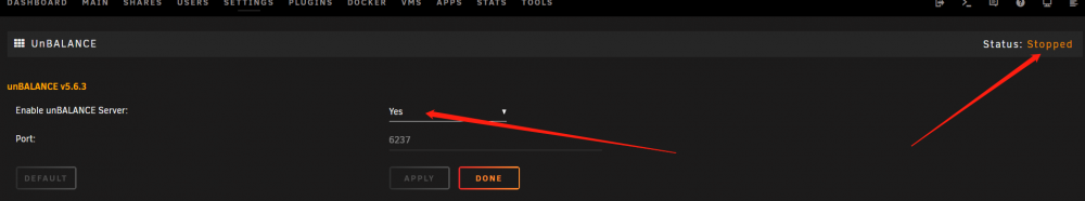

I enabled the server, and still can't start unBALANCE, and where is the web link?
You clicked done after switching it to yes?  The link will show up above the unBalance v5.6.3.
yes, and nothing happened. The page is till the same...

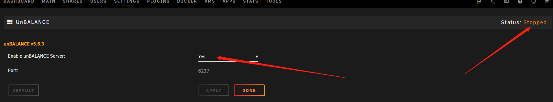

The green is the link.  when you switched it to yes did the apply button light up?
After I clicked the DONE button, the page jumped to the SETTINGS page. And I re-opened the UNbalance, nothing happened, didn't see that green link..
You have to click apply to get it running...
Try running unbalance from the command line, to check for any error
/usr/local/emhttp/plugins/unbalance/unbalance -port 6237
Hate to be one of those guys, but noticed that mine wouldn't start either, so I've just run the above and got...
configuration variable provided but not defined: notifyCalc
Usage of /usr/local/emhttp/plugins/unbalance/unbalance:
  -apiFolders="/var/local/emhttp": folders to look for api endpoints
  -checkForUpdate=1: checkForUpdate: 0 - dont' check; 1 (default) - check
  -config="/boot/config/plugins/unbalance/unbalance.conf": config location
  -dryRun=true: perform a dry-run rather than actual work
  -folders="": deprecated - do not use
  -logdir="/boot/logs": pathname where log file will be written to
  -notifyPlan=0: notify via email after plan operation has completed (unraid notifications must be set up first): 0 - No notifications; 1 - Simple notifications; 2 - Detailed notifications
  -notifyTransfer=0: notify via email after transfer operation has completed (unraid notifications must be set up first): 0 - No notifications; 1 - Simple notifications; 2 - Detailed notifications
  -port="6237": port to run the server
  -refreshRate=250: how often to refresh the ui while running a command (in milliseconds)
  -reservedAmount=512: Minimun Amount of space to reserve
  -reservedUnit="Mb": Reserved Amount unit: Mb, Gb or %
  -rsyncArgs="-X": custom rsync arguments
  -verbosity=0: include rsync output in log files: 0 (default) - include; 1 - do not include
2020/10/12 19:19:33 Unable to start the app: configuration variable provided but not defined: notifyCalc
This has to do with the configuration file /boot/config/plugins/unbalance/unbalance.conf
You can remove the notifyCalc line (or any other if you still get an error), or ... delete the config file altogether.
Thank you!  renamed the file unbalance_old.conf and it started up fine.
