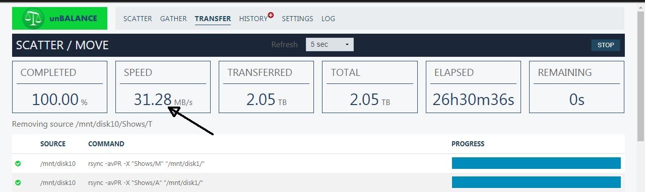

I started a Gather operation for about 6TB of data.
It is showing 105hrs remaining and the transfer speed is continuously slowing down (from 105Mbps to now 14.5Mbps)
So what happens if i stop the process?
Also the disks support much faster transfer speeds so why is it so slow?
I have no docker containers and those disks aren't being used at all over the network.

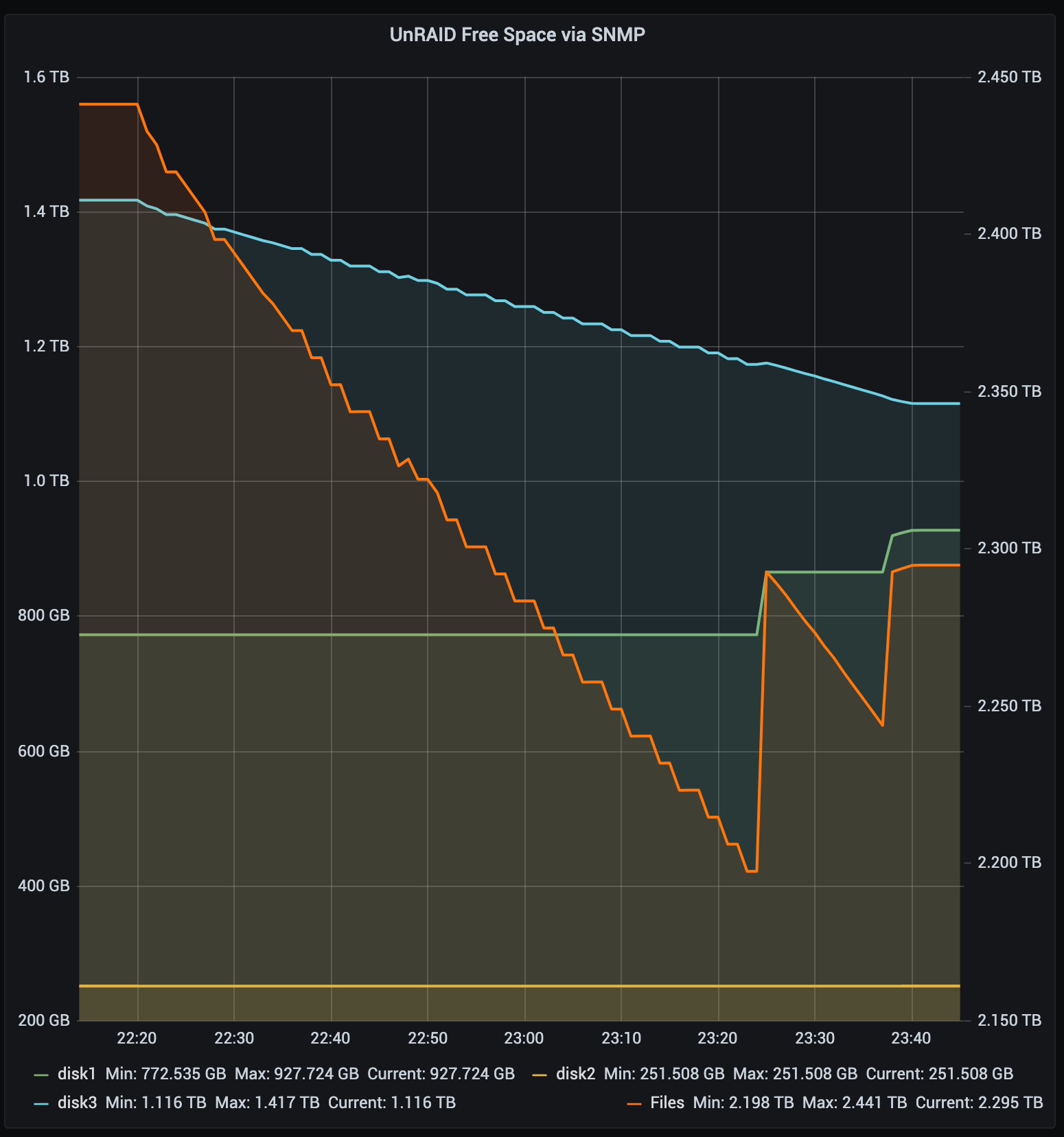

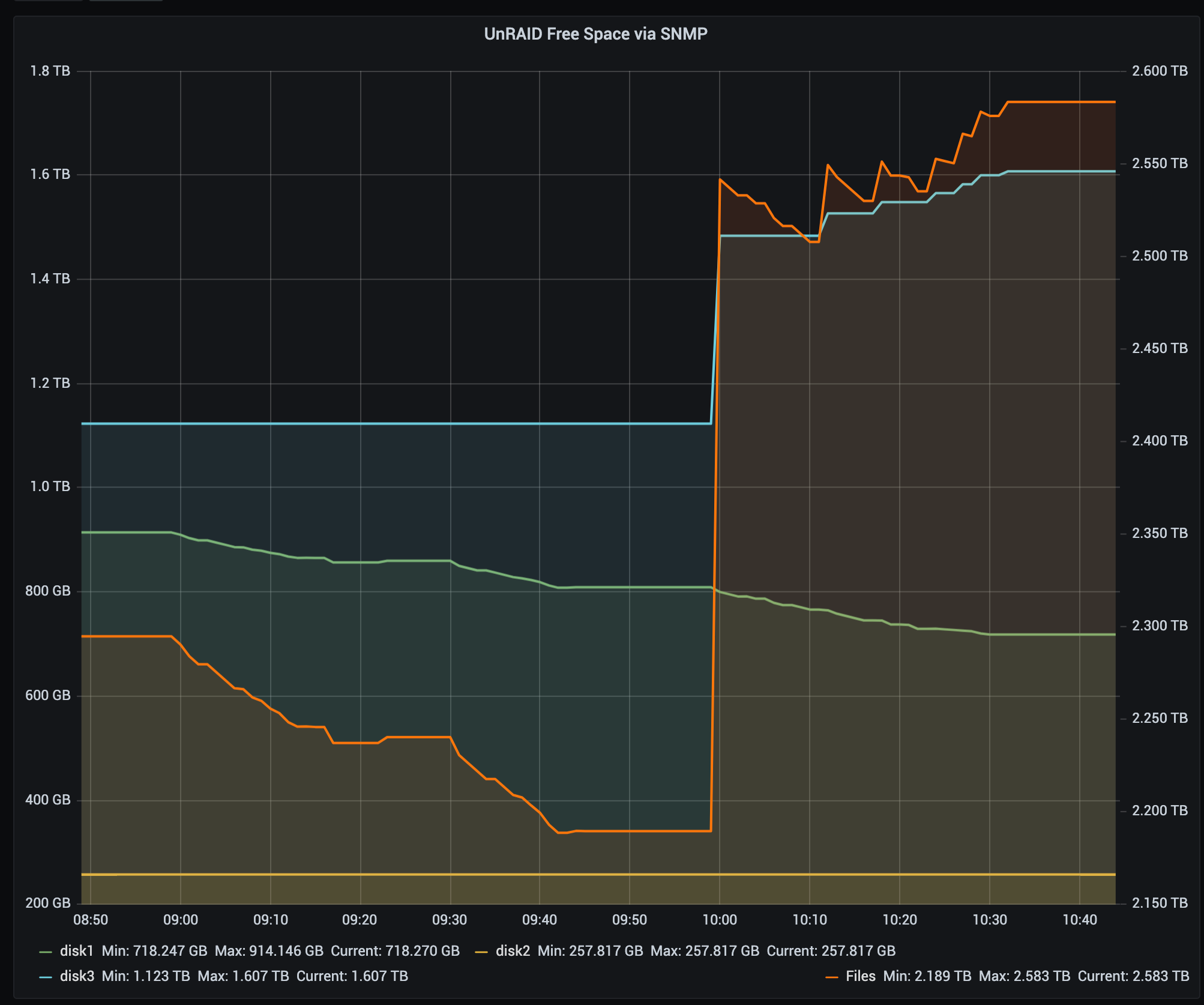

  • I have three disks + parity and set Unbalance to move about 300GB of files from Disk 1 to Disk 3.
  • I confirmed that I ran the New Permissions script immediately before executing, and I received no permissions warnings when running Plan in Unbalance
  • I have my rsync settings at the default, which seems to just populate the field with -X. I confirmed that during execution it uses rsync -avPR -X "source" "dest" so I think this is set up as intended
  • I have a share called Files that pulls from both disks.
  • Disk 2 is untouched unmodified in this process
  • Unbalance runs, and notes in its email that it has moved about, 300GB of data
  • The free space on Disk 1 goes from 772GB to 928GB, about 156GB removed
  • Disk 3's free space goes from 1417GB down to 1116GB, about 300GB of data added
  • The File share's free space goes from 2441GB to 2295GB, or about 146GB less free space after the move
This seems to me as if Unbalance successfully copied the full 300GB set of data from Disk 1 to Disk 3, but was unable to delete 146GB of data from Disk 1 after moving. I would have expected the share to have the same amount of free space before and after moving, but this does not seem to be the case.
I've confirmed that the syslog doesn't output any errors or other logs during the Move, and I scanned through /boot/logs/unbalance.log to confirm everything looked OK there.
I just had a thought that perhaps this has something to do with the sparse files of my VM disk backups. For example, I have a 100GB .vdmk file that only occupies 20GB on disk, and perhaps after rsync it occupies the full 100GB. Put a couple of VM backups together and we have our missing 146GB. In other words, the disk space estimate for Disk 1 was using the occupied space and not the total space, while the rsync move and the files that resulted have matching occupied and total space.
I've done some additional testing and confirmed this is what was happening. I had to update the Unbalance rsync settings from the default -X to -X --sparse as I found in the Rsync man page and a forum discussion https://communities.vmware.com/t5/Technical-Community-Resources/copying-virtual-disk-images-with-rsync/m-p/848647 https://linux.die.net/man/1/rsync
After making that change in the Unbalance settings and running the transfer again, everything worked exactly as expected. A huge amount of space was freed up on the share, meaning that the VM backups were able to regain their sparseness and only occupy part of the disk. Nice!
So as a warning to people out there: If you use Unraid for virtual machine images or other sparse files, make sure to use --sparse as an option when running Rsync.
Is it possible that one of the disks involved in the operation is not quite healthy ?
Slowing down that much feels to me like some disks is having i/o issues.
In the unbalance UI, I added the link to a plugin by a fellow forum member that looks at the health of a disk.
Can you check that ?

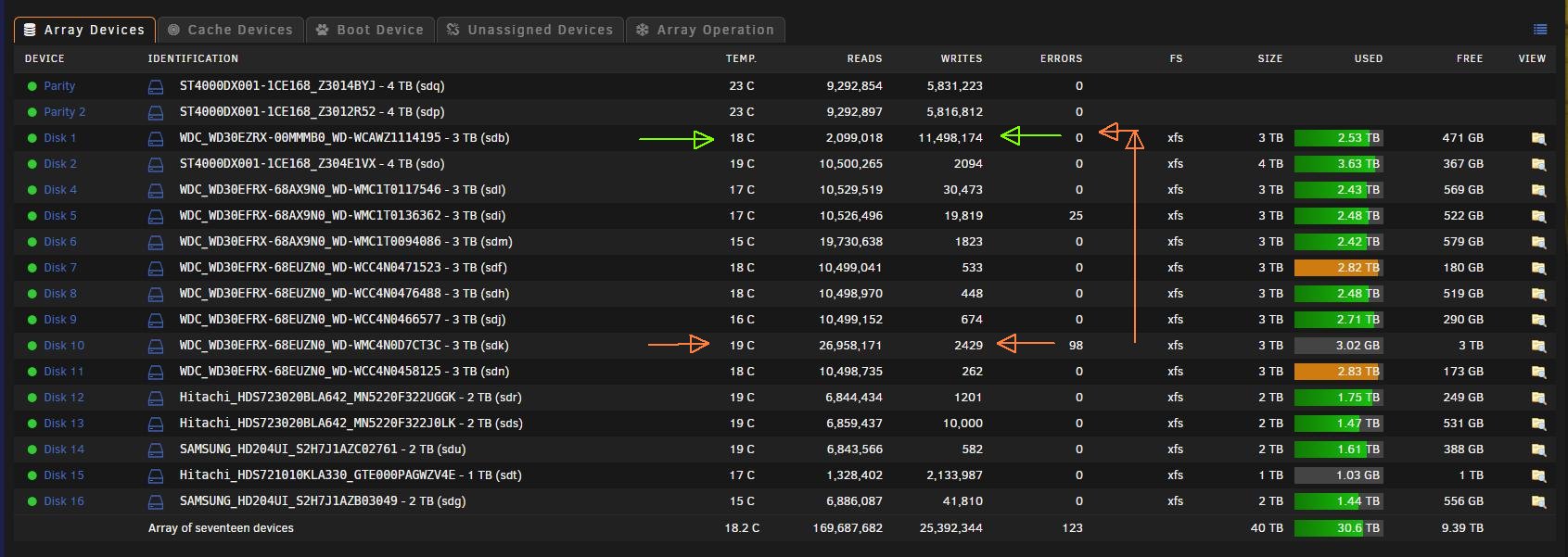

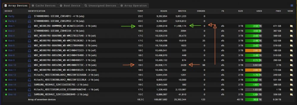

At the moment i am "rescuing" a failing 3 TB disk and I observed another strange phenomenon in the Unraid Main view :
Take a look at the reads and writes for the 2 parity disks, then the read and writes for disk 10 (source) and disk 01 (target) and all the other disks.
In a perfect world all drives but 10 and 01 should be and stay spun down and the transfer speeds should be between 120 and 180 MByte per second rather than 30-50 MB/sec average.
Another nice thing would be nice if the read errors defective files or HDD segments would not be UNB "moved" and one could find out the name of the "lost" files.
I attached 2 screen shots to explain what i mean ...
