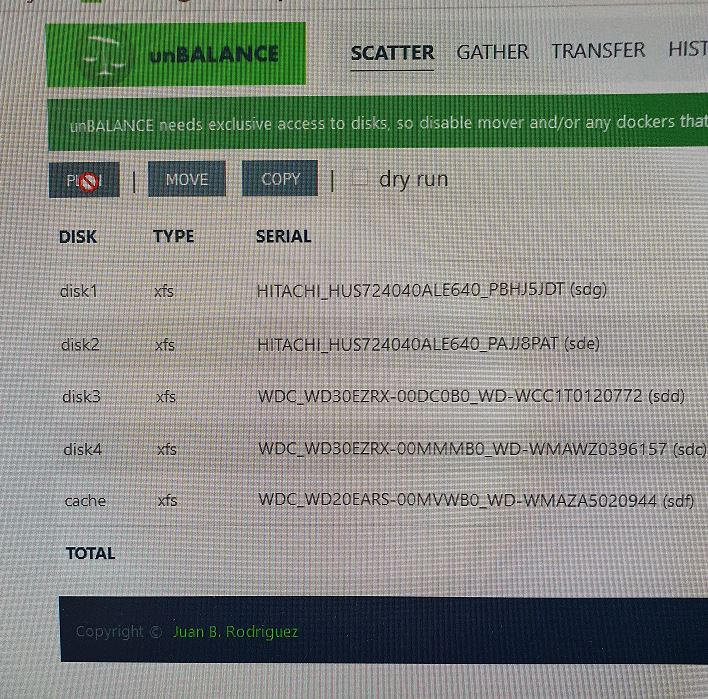

I'm currently having a problem with unBalance.  Don't know what's causing it, because I've used unBalance in the past on this unRaid setup no problem (just last week in fact).
But now, when I try to click on either "plan", "move" or "copy" I get the "not allowed" symbol and can't click it.  I also cannot select "dry run".  I can select the "from" and "to" on the disks, but without being able to click the pla, copy or move options, there's not much point.
I've got a feeling this is something stupid I'm missing, but I cannot see it.  Have already tried difference browsers.
odd, you should be able to click on the plan button. screenshot ?
I've added a screenshot. Sorry about the poor quality: had to take it with my mobile phone because in a normal screenshot the mouse error didn't show.
Sorry, not visible on the screenshot, but yes.  It doesn't change anything though.
i'd try uninstall/install then, see if it makes a difference :) not sure what the issue can be.
Ok, I'll give that a try! (and report back :) )
Edited by BartDG
No luck.  Uninstalling and re-installing gives the same result. :(
