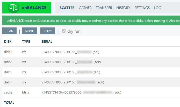

On 1/29/2022 at 9:47 PM, rallos_hoo said:
hello,
Due to unraid 6.9 now support multiple cache pools, may this plugin add the feature moving files between cache pools?
From what I've seen it certainly does. When I selected files on a disk I was clearing, it defaulted to selecting all other disks as destinations. I had to specifically remove my two pools in order to get it to not put data there.
I'm reasonably certain that if you select data that's on one of your pools, you could select the other pool as the destination.

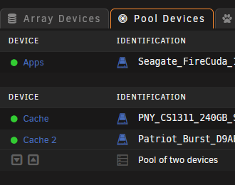

No, I don't think it does see any more than the "original" cache. Can you show a screenshot?
My pool drives:
Unbalance, in SCATTER mode, showing the option to move data to both pools:
Unbalance in GATHER mode showing the option to move data to either pool:
The most annoying part, to me, was that they are selected by default in SCATTER mode and I had to constantly remember to deselect them as I was moving data off of my failing drive. It would be great if there were some settings that would cause Unbalance to ignore drives when selecting the default set of destinations. More than once, I accidentally moved data to both pools, then had to go clean it up again.
Are you sure you're on the latest version? I don't have a clue when the plugin was last updated, but I've got CA doing automatic updates, so reasonably certain that I'm on whatever the latest may be.
Edited by FreeMan

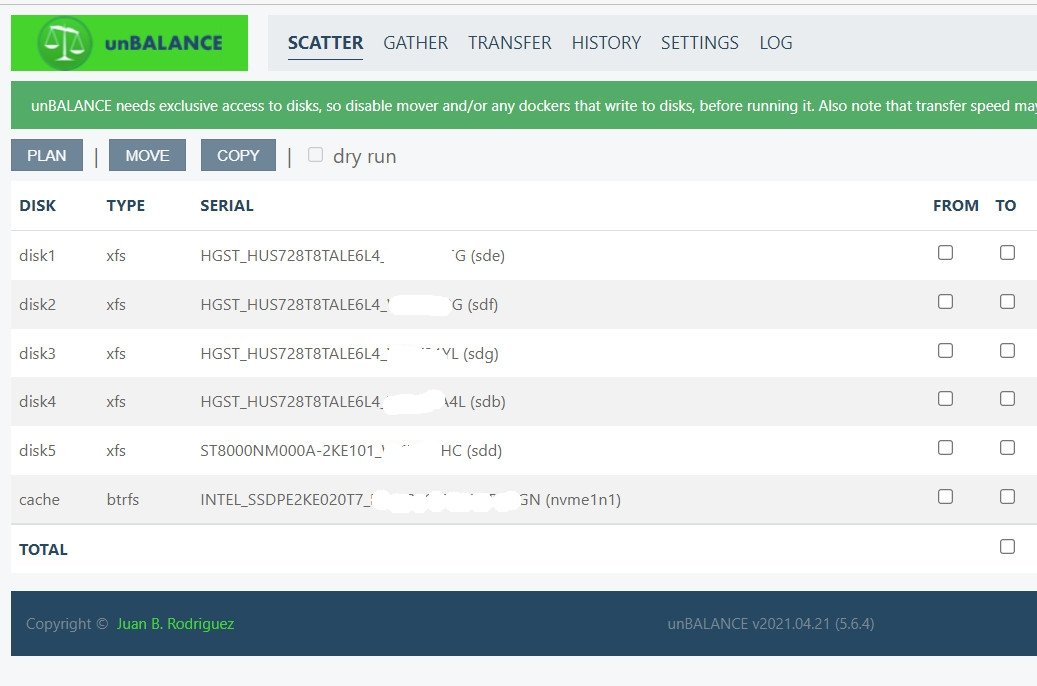

I am confused, what's wrong with my Unbalance????
Cause my cache device is nvme SSD ???
2022-02-06_110054.thumb.jpg.5e06eaf6eae4d7072dfd0746e7644b22.jpg2022-02-06_110901.jpg.5179c2aa7fbc3aa51495d0fa58d364ac.jpg
Edited by rallos_hoo

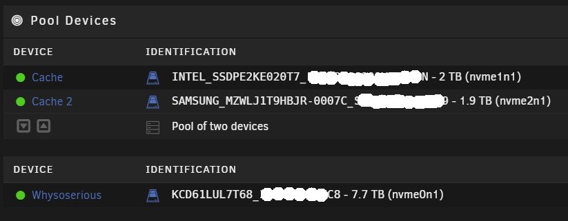

Mine are standard SATA SSDs - maybe that's the difference. AIUI, there are some issues with NVME devices here and there, but I don't know all the details. Maybe do some searches throughout the forum to see what you can turn up. Make sure you know which version of UNRAID they refer to because I know support has been improving.

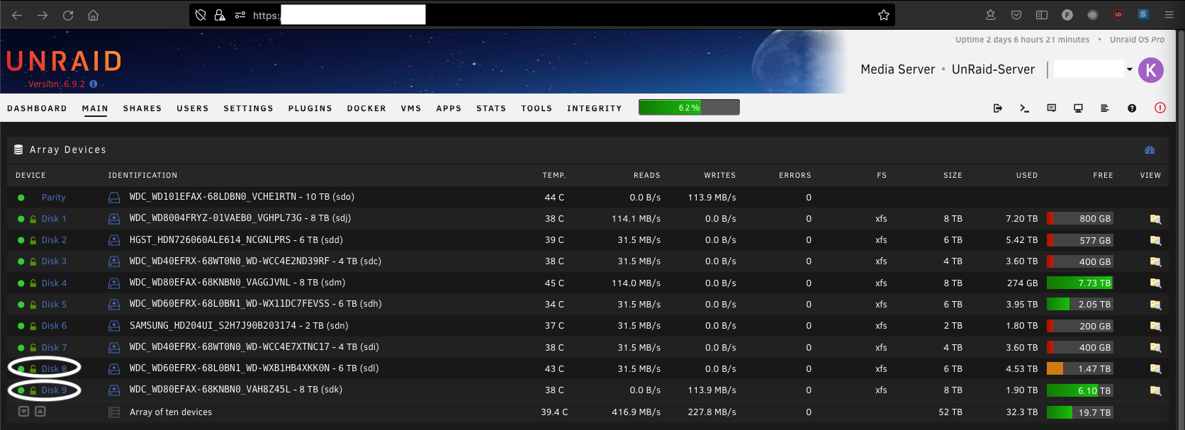

Hi all.
After upgrading parity disk to a bigger one I added the old parity disk to the array, now with more free space I want to move files from Disk1 to Disk3 but no matter hoy much I tried unBalance isn't doing anything.
I've tried scatter, select folder to be move from Disk1, then select destination Disk3, when pressed Plan permissions error or warning shows as this:

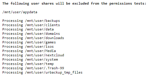

Ran Fix common problems extended test and it returned this: (other directories and irrelevant info not included on the screenshot)
If I continue and select move it says all files were moved but after checking destination Disk that isn't true. Tried copy instead but same result.
All Dockers are stopped as well as VMs.
Any hints?
