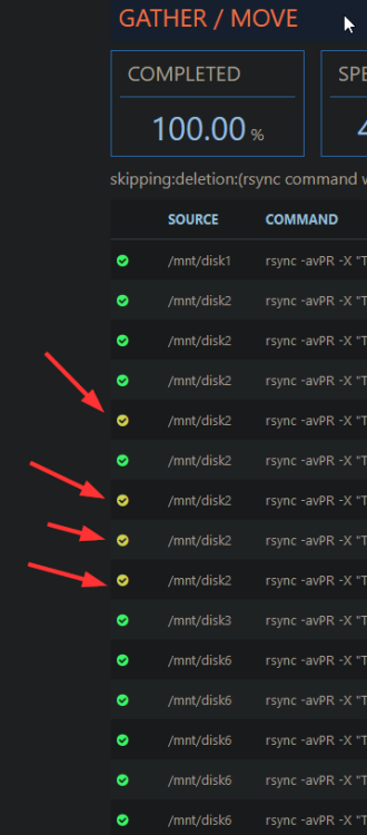

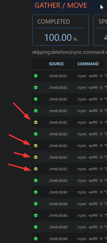

What do the yellow check marks mean?
I don't think I've ever seen that before yesterday, and I saw nothing about it on the GitHub page. (Maybe I just missed seeing it)
It's also telling me
skipping:deletion:(rsync command was flagged):(/mnt/disk5/TV/Emergency!/Season 07)
Which looks like it's trying to delete from disk5, but disk 5 is the destination, not one of the sources.
Edited by FreeMan
yes, that's the destination, it's just showing the rsync "to" command
the yellow check mark indicates that there was an issue with that specific command, so the app didn't delete the source folder, the reason can be anything that rsync reports
